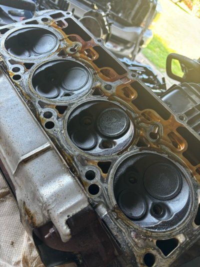

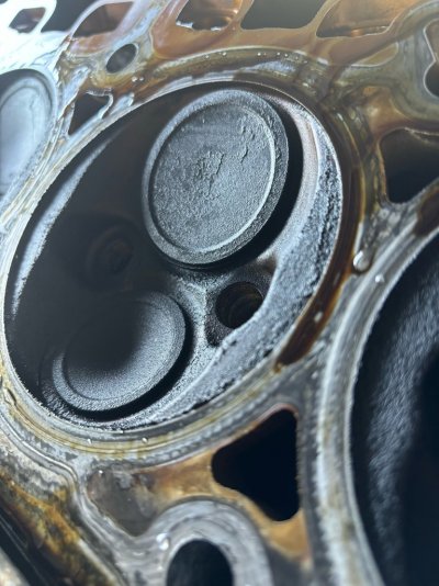

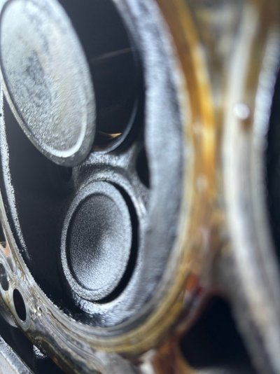

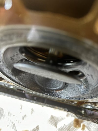

Gave in and pulled the driver side head since no matter what I did cylinder 3 was always dead.. and finally found the culprit ‍♂️
