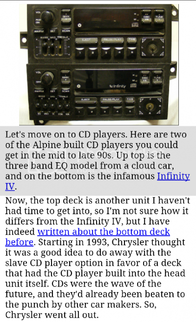

Hey yall
I have the top radio in the pic .. it doesn't say infinity on it but I do have the A pillar speakers
Anyone know for sure if it's not an infinity system ?
I want to replace the head unit but not the speakers
Thx for any help

yep its an an infinity system ... i pulled the door panel off today

Mine doesn't say that either, general rule of thumb is that if it has tweeters, it's Infinity because that's the only way you could get those.

Infinity or not the radios are all interchangable as long as the mounting tabs are in the right place.

I have the Infinity IV AM/FM/CD and need the method to set the clock - just bought my 1996 SLT with the 8L V10.... Can you help me?

Spamcan, I answered your other thread but look at the pics above. Stick a needle in the M or H in the readout screen. That is how to adjust the time.

OMG, completely missed those dimples, what with my automatic shading eyeglasses and facing the windshield I just couldn't pick 'em out! Now I know they're there, they're obvious! Adjusted the clock just fine... THANKS!
