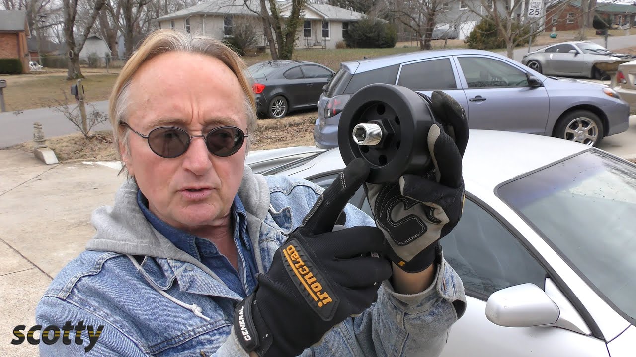

Came across this on youtube. Scotty endorced the company. It's $300. What do you think? Has anyone tried it out?
Baxter performance website.
Installation of the Baxter Performance spin on adapter.
Scotty's endorcement

In my opinion this is silly and a complete waste of money. I don't get the point of it.
It does nothing to eliminate any of the potential problem spots that the pentastar oil filter / cooler assembly has in terms of leaks. To me, the stress and movement from having a spin on filter hanging way off the end of the OE housing is just going to stress the plastic filter / cooler housing even more, causing it to leak sooner.
All this ~$300 device is doing is replacing the cap with a fancy insert allowing you to use a spin on filter that likely has less filtering media than the OEM drop-in element.
Now if they had an all aluminum replacement filter / cooler housing, they'd have something.

You'd also have to remove this entire unit during every oil change to replace not one but 2 O-ring gaskets. One on the stupid plastic cap that comes stock and now one on this adapter. Last time I checked the filters only come with one. So what are you going to to, keep replacing the top one and then moving the top one down or make sure you buy an extra O-ring every time you buy supplies to change your oil? You certainly aren't going to Jiffy Lube because I don't think they'll change either one. All I want is an all metal housing AND metal cap that won't leak all over the place every other oil change! I never had a problem changing my oil with a spin on filter that hung on the bottom of my engine. All of sudden some "genius" has the bright idea of putting the filter up on top and now every other oil change the cap leaks because that STUPID O-ring has slid out of place or the cap is too tight or too loose, or the moon is in alignment with Jupiter or whatever the reason.

From what I gather the Baxter oil filter adapter has a built in check valve that keeps the oil from draining out of the high mounted filter back into the oil pan This oil drain back which takes about 38 seconds, causes a dry start on the engine for the first 3 seconds. The Baxter adapter keeps oil in the filter and reduces the length of time the engine runs dry on start up.
