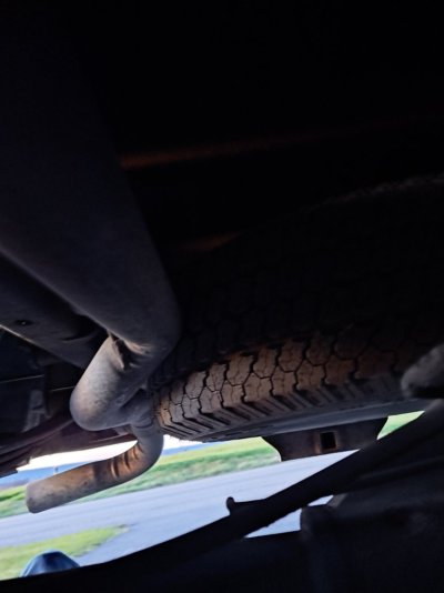

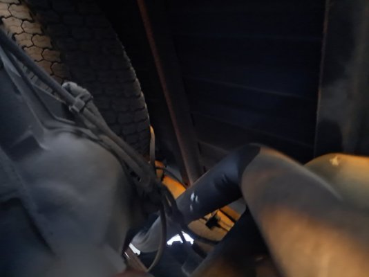

427invader
Dec 21, 2011
171
34
Shippensburg, PA
Here are a few pics from my '04 Ram 1500 5.7l hemi. This is all 3" dual exhaust after the cats.The 2nd and 4th pic is the driver side over the axle. The 5th pic is of the driver side from the tailgate.
20240329_194355.jpg20240329_194432.jpg20240329_194452.jpg20240329_194605.jpg20240329_194659.jpg
