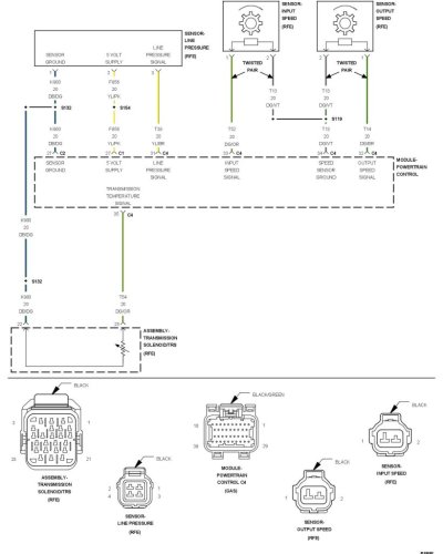

So I’m assuming pin 2 and 3 are shorted together somewhere along the way, the ground seems fine, and neither are shorted together ground, but both the 5v supply and the transmission line pressure signal have 5v, if I wiggle things around the line pressure signal varies.
Going to run new wires for the 5v supply to pin 27 on c1 and the signal wire to pin 31 on c4

update, ran the new wires and I am still getting a solid 5v to both 2 and 3.
Just to check, am I correct in thinking that I should only have 5V going to 2, and no voltage going to 3 when the wiring harness is unplugged from the sensor?
My understanding is that you have your ground, 5 volt coming from pin 27 to pin 2, and then the pressure sensor adjusts that 5v and sends back anywhere from .35 to 4.75v to the PCM pin 31.
If this is the case, and I am not incorrect, I would assume the PCM has failed in a way where it is incorrectly sending 5v from pin 31 on C4.
I have attached the wiring schematic I am looking at just for reference.

Further update, I was in fact incorrect, pin 31 at the pcm produces 5v when the wiring harness is disconnected. When connected it’s reading within range. I’m assuming this is a fail safe so if it the pressure sensor fails it’ll throw itself into limp mode.
So wiring, pcm and sensor seem to be doing what they should.
