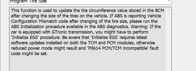

Also got the pop-up below regarding resetting the ABS system. I didn't get an error specific to the EGS, so I'm not resetting that one yet.

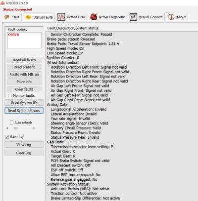

Thanks. Yeah, I'm leaning towards a little drive time so it can collect some data. A common error below is "Signal not valid" for wheel rotation direction, etc. Also, code C0078 (tire-size mismatch). I'm going to clear that and get this thing on the road for awhile.

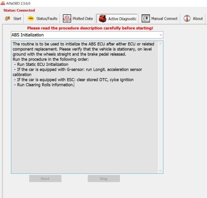

OK. GOT IT!!!!
The ABS error was causing ALL the other errors listed in my previous post.
Followed the ABS Initialization procedure below EXACTLY and all seven items in my list cleared. :cool:
Took most of the day for me to do a 20 minute job I suppose...but it's done, and I learned quite a bit.

I've been tweaking the tire circumference sizes on my '21 Warlock using AlfaOBD for a couple of years, twice /year for summer and winter wheels. I have never had to reset the ABS module, but during the last tweak, everything went crazy.
A long story short, while I was driving home from a dealership after a maintenance/warranty check that included changing to my summer wheels, I had the brilliant idea of resetting the wheel circumference.
After resetting the wheel circumference, I received 5 or 6 notifications on the dash, CEL, no EPS or speedo. I toured the settings and found a few things out of whack, so I tried to restore the settings to several backup files using AlfaOBD. No Joy.
I'm sitting at the side of the road in rural BFN on a Friday afternoon, a bit more than mildly concerned and decided to bail out after having no success with restoring to backups.
I called an SA I knew at the dealership, drove back on the highway with no speedo or EPS, and he re-flashed the BCM. Solved my headaches for no charge with a smile.
After I got home, I read much of the AlfaOBD thread again and many other posts here, there and elsewhere about changing the wheel circumference sizes using AlfaOBD.
I'm convinced that any grief with CELs or failure notifications after a wheel circumference tweak should be responded to by re-initializing the ABS module as a SOP.
There is a reason that Alexey has this ABS module init. warning.
I suspect that the ABS module occasionally loses its mind after a wheel circumference change and spews out garbage on the CAN bus network, killing the connection to many other modules. Hence, the myriad of unrelated modules that fail to connect.
I've learned my lesson and won't forget about that ABS module that requires a slap to get back in line. :cool:
