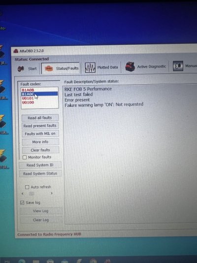

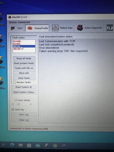

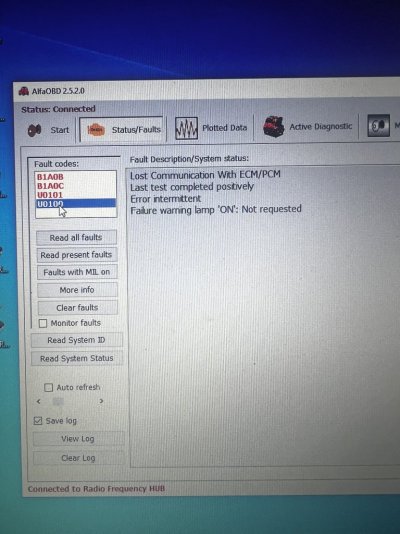

Ok, I’ve cleared the 100 and 101 codes and they do not read now. I thought I had done this before but I guess I did not. Now my only codes in the RF Hub are the fob codes B1A0B and B1A0C. Which with my research so far only points to
• Excessive press from Keyless Entry Fob (RKE) transmitter when is out of range
• Faulty Keyless Entry Fob (RKE) Transmitter
• Faulty Totally Integrated Power Module (TIPM)
For me, maybe I pressed too many times on the fob out of range? But then again the new fobs seem to programmed but not be married to the vehicle, or else if I push the start button with the actual fob it tells me “wrong fob.” My old fob works that way though. I have a hard time believing my TIPM is smoked, as it actually was acting up before an accident a year ago and when the body shop put things back together they replaced the TIPM. So it’s basically brand new.
So I’m thinking what are the chances these new fobs are faulty? Both of them at that?

Yea that’s what I meant I cleared ALL codes already. The B1A0B/C codes come right back as soon as you press a button on new fob again.
And yea I also cleared them and tried to add them and it told me they are already programmed and can’t be reprogrammed.
I’ve returned and gotten two brand new fobs with same exact problem again. Happens after first startup and drive. I reset ECU and reset RFhub just after programming fobs too. They worked for hours (I kept walking around house testing lock and unlock button) then as soon as I started truck and drove it, parked and shut down, they stopped working and same “wrong fob” error on dash when I tried to press fob against start button.
Also, noticed this time I was sitting in the truck alone sulking after shutting it off, dash finally shut down completely. I tried the fob button again just in case, and I noticed the lights on the gauges would light back up. But no screen or anything else, much less door lock or truck start.
So obviously they are still sending and receiving signal to the hub?

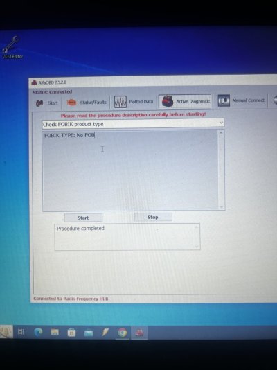

how would one test all functions besides just physical observation of connections and antennae?
You would think if it’s Rf hub failure it would just not pair to begin with, or not notice the fob after some time. This only happens after 1 startup and drive.
I could pull the other new fob out of the box, program it seamlessly right away, and then after taking it for a drive with next new fob it will do the same thing.
The signal is getting there and also being received, proven by the gauges lighting up again after pressing button.
And even trying to program them again, it acknowledges the fob and says it can’t be programmed because it’s already been programmed.

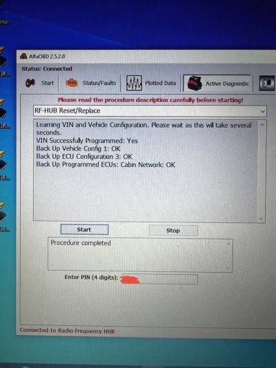

Yea, you'd think. But, when the RF hub is a computer, communicating with another computer, wth all of the various functions that these parts control, it's unlikely that ALL of the RF hubs functions failed at the same time.
If, the RF hub is the problem, more likely that just one of its various functions failed. Perhaps not even the RF hub, but perhaps one of the antennas.
The baseline system, like mine, only has one antenna. It reads the lock/unlock and remote start. On mine, the win module reads the keys RFID chip, for engine start.
The high line system (push button start), has 2 antennas. One for door lock/unlock, and a second antenna that reads the keys RFID, to allow for the push button.
It's possible that something on the RFID side of you rf hub **** the bed, while the other side is still fine. Or, maybe a rat ate through a wire somewhere, a leak happened, or any number of other possibilities. The only way to know is to diagnose, inspect the parts and/or start replacing parts.
Often, when computers fail, there is no external indicator aside from the symptom.
It sucks, but I've been there.
Get the part# off of your RF hub and find a used one on eBay they go for around a hundred bucks.

Can't AlphaOBD write the VIN to the hub. I'm pretty sure I just saw a post recently from someone who did it.
Maybe I'm remembering wrong though.

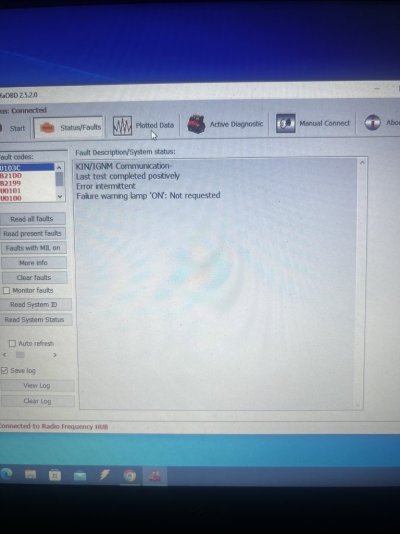

Ok how about this, I am also getting codes in the body control module. My right side blinkers, tail and headlights keep signaling they are out but work fine. Checking into the codes it looks like U0147 can have something to do with a problem with the CAN bus circuit and different modules communicating with eachother? Could that be behind some problems maybe?
Maybe it’s the Rf hub, maybe not, idk. But I would hate to buy a new hub and go through all the steps to try to copy vin and possibly f it up, and it not be the issue. I have a hard time believing it’s just the Rf hub as like I said it all works totally fine, for hours even, until 1 start stop cycle. I feel if it actually is in Rf hub it has to be software related and not the actual hub.

Yea, that definitely points towards something other than the RF hub.
Check the big BCM connector above left of the brake pedal. I accidentally pulled the cam lever loose once with my foot, and it caused all kinds of weird errors and codes.
