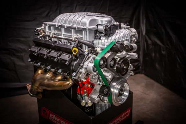

Put the Hellephant in there and be done with it! :driver:
