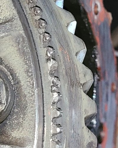

jordankeck
Aug 2, 2023
8
Indiana
Another update: I pulled the rear diff cover and found that the previous owner must have broken the speed sensor off in the housing where it damaged the ABS tone ring teeth. I will be replacing the ABS tone ring if anyone has one. Just closing the loop on this so anyone searching has useful info.
