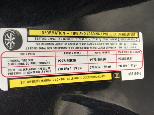

Now take the stickers on my truck, first the door jamb. Same basic numbers as above.
The the nasty tire sticker (because FCA put Passenger tires on a Truck):
Max load: 1116 lbs ... no where near the 1450 they claimed. No big deal, can upgrade tires... but can you get a new sticker for the new tires? Hmmm...
So all that being said now comes the worst part, the TRUE math, no marketing crap or lying dealers/FCA:
GVWR: 6900 lbs
Weight of truck empty but with full fuel: 5880 lbs
6900 - 5880 = 1020 lbs
This leaves us with 1020 lbs of "legal" payload. My god my Jeep Rubicon Unlimited has more payload than this (but sure as hell isn't listed as being cable to tow 9000+ pounds, it's rated for 3500).

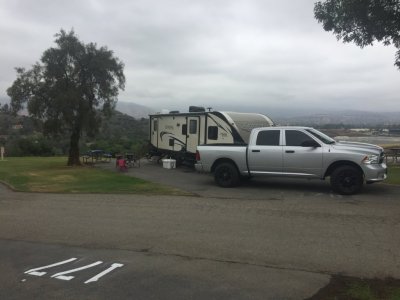

My existing travel trailer, a tiny little Jayco 17z hybrid (3500 max GVWR) has a dry (read: WAY underrated in the brochure) weight of 340 lbs. Add battery and two propane tanks:
340 + 50lbs Battery + 37 lbs LP + 37lbs LP = 464 lbs calculated and that is with weight in the front storage.
So my truck with family in it (and no jackets, food, video games, iPhones lol) has just 470 lbs of payload left.
470 - 464 lbs = 6 lbs of Cargo left!!!! :crazy:
So my brand new killer pickup CANNOT legally tow my little tiny 17z trailer that my Jeep unlimited could (legally). And this is without a real hitch weight... I have a sherline scale so I'm going to go out and weight the 17z in a few minutes just to see what the REAL tongue weight is.

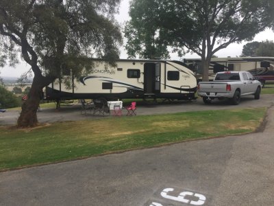

Now yes, I see Ram Hemi's every day (Laramies with full air suspension) pulling 37 foot Starcraft monsters loaded to the gills... The truck "can" do it, just not legally. Going to open a beer tonight and throw darts at random objects lol...
Please someone tell me where my math went wrong lol!
