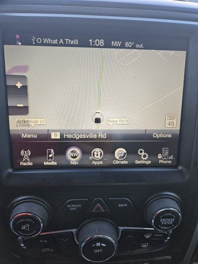

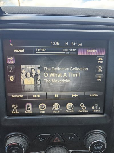

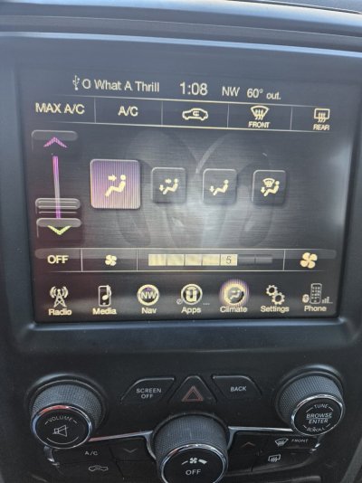

Hi everyone, I recently purchased a used 8.4 Uconnect to put in my 17 Ram. I purchased the wiring from M2Mods (Mike Grimm). The radio and heating/AC work great, no issues other than screen discoloration. My reds are showing up as Purple and things look off compared to other 8.4 Radios that I have been around. I tried changing Themes with no luck. I reset the radio to factory with no luck either. Last night I upgraded the radio with latest Uconnect software. Still no fix. I messaged Mike Grimm today and he told me he has never seen this problem before. His suggestion was either replace screen or whole radio needs replaced.
Before I throw more money into this project, I was going to see if any of you had similar problems and had a solution.

SitKneelBend, it does that when the radio comes on and looks like that the whole time. It is not hot on the back either when I checked it. I was hoping that there was a secret contrast adjust menu that I couldn't find like old TV's had. I looked through the internet and found a engineering menu and a dealer menu. But neither had options to adjust the screen.

Nope, no adjustments unfortunately. It's possible a ribbon cable internally is not seated properly causing color distortion, but I have never seen one look washed out from the ribbon cable issues. I can also see the backlight is pretty uneven and bloomy on the edge.
If it's not overheating, I'd reseat the cables first as a free test and if no change just swap screens entirely.
EDIT: Actually upon closer inspection of your pictures I am seeing some artifacts on screen indicative of a bad cable or one that isn't seated properly. Hopefully you get lucky and that is the culprit!
