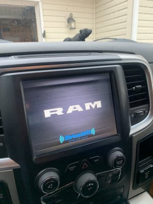

I've heard from multiple people that you cannot downgrade a UAQ radio. This is simply not true. There are some hurdles you sometimes have to jump through in order to complete the downgrade. I'll get to that, but just know that you are not SOL if you updated and something was broken. It CAN be fixed. Don't mail it in for $500+ to do a simple repair.
I was able to get my hands on a UAQ 34.2 update file and installed it and found it to be working fine. However, any time I would restart the car, the SiriusXM favorites would reset back to factory defaults. Not a big deal, but we do like to have our SiriusXM favorites. So here's my fix:
I tried to downgrade to 22.6, but could not. It said the update was not compatible with this vehicle. If this happens to you where you're having issues on your current version, DO NOT PANIC. You can downgrade the radio no problem. I was able to get my hands on a UAQ 30.24 update file. I put this on a drive and inserted it into the USB. It allowed me to "Update Now" which I did. I was able to flash the 30.24 update file onto the UAQ. Now here's the cool part. After I flashed 30.24, I went to see if I could downgrade to 28.3. I could! It said "Update Now" just like it did with 30.24! Awesome! Although I didn't try this personally, I have all the faith in the world that it would downgrade just like it did from 34.2 to 30.24. Heck you might be able to even downgrade 28.3 to 22.6

I have personally installed all three of these on my Compass/Cherokee and RAM UAQ radio and all functionality including SiriusXM, Navigation, CarPlay, backup camera, etc. all work with zero issues.
