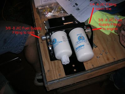

Install connectors to AirDog II
-1/8 x -4 JIC fitting on air/vapor return port (engine side, middle port)
-3/8 NPT x -8 JIC flare fitting on fuel supply port (engine side, right port)
-3/8 NPT x -8 JIC flare fitting on fuel supply port (tank side)
Use locktite 2760 on all 3 fittings

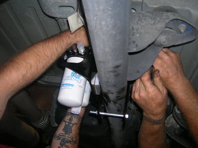

Attach mounting bracket to frame bracket.
-mounted inside frame rail near transfer case

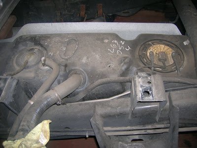

Decided to pull the bed instead of dropping the tank because of the amount of fuel left in the tank.
-there are 8 18mm bolts holding the bed on
-there is a 10mm ground on the front passenger side
-disconnect the fuel filler neck: use flat blade screw driver to undo band clamp
-disconnect the tail lights
-support the bed and lift
First discrepancy with instructions found once tank was clear. In the fuel filter housing used in the instructions the tank vent is in the top of the housing. Our tank has two vents at either end.

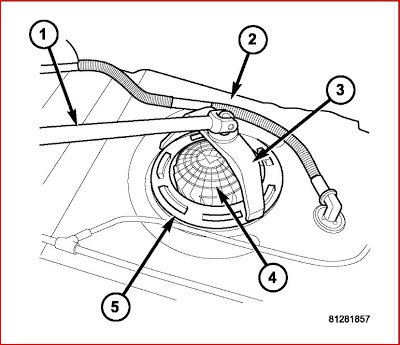

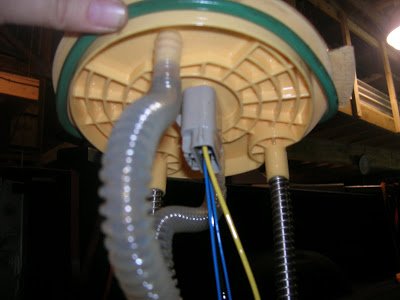

Remove Stock in-tank Fuel Pump Housing
-disconnect wiring for fuel pump
-disconnect fuel return line
-disconnect fuel supply line
There is a specialty tool (9340) to remove the lock ring, a flat blade screw driver and hammer will turn and remove
*take care when removing housing as the cup will be full of fuel*

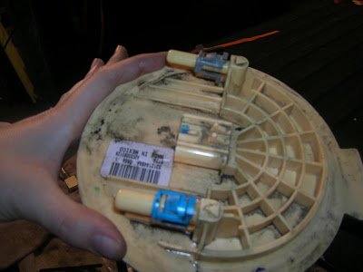

Found second descrepency with instructions. The in-tank fuel filter housing shown in instructions has a clear space to drill the 9/16 hole for fuel supply line. Ours had honeycomb re-enforcing; while we could have nibbled it out to make a flat spot for the washers and bulkehead fitting the high chance of damaging the top of the housing made us decide to mount the fuel supply for the AirDog in the tank itself and connect to the fuel supply line to the anchor block.

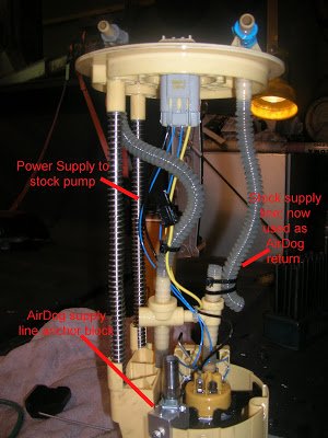

-disconnect power supply for intank pump, there are two push tabs (front & back) then zip tie out of the way
-the stock fuel supply line will now be used as a vapor return line for the Air Dog so the line needs to be cut above the fitting and zip tied in place
-drill and install anchor block
-when setting the suction tub insure the tab is holding the bottom of the tube off the bottom of the housing

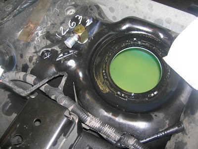

-drilled 9/16 hole in tank
-install -8 JIC 3/8 NPT fitting in bulkhead fitting
-secure in tank with provided washer, gasket, and nut
(really that's not algae in the tank; it's lined and the flash reflected badly. Fuel was a nice clear blueish-yellow color)

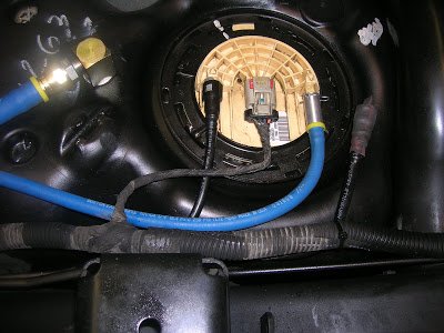

Connect Vapor Return Line from Air Dog to Tank
-connect 3/8 quick connect fitting on 1/4 hose for vapor return line
-connect to 1/8 x -4 JIC fitting on air/vapor return port (engine side, middle port)
-size hose to tank and cut excess
-connect 1/4 barb x -4 JIC swivel

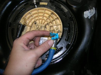

-remove the plastic lock (blue) from stock fuel supply on housing
-user provided retaining clip to secure return tube to housing
Connect Fuel Supply Line from Air Dog to Tank
-connect -8 swivel connector to 1/2 fuel line
-connect to 3/8 NPT x -8 JIC flare fitting on fuel supply port (tank side)
-connect to -8 JIC 3/8 NPT fitting in bulkhead fitting
