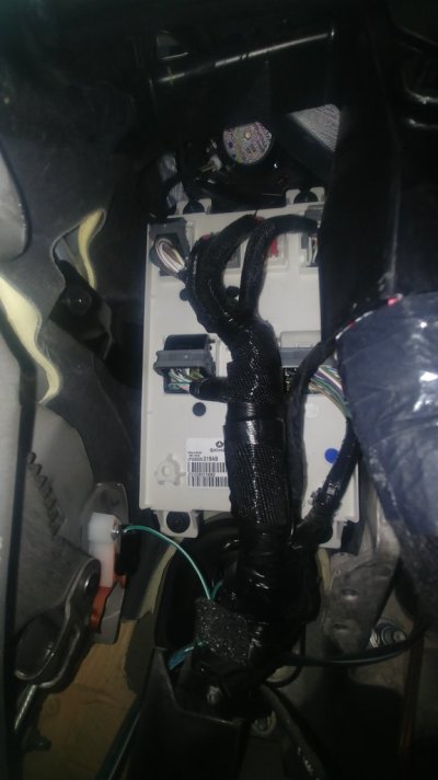

I have a 2016 bighorn with the Harmon karden head unit in it stock does this system have the factory amplifier or notwhere would it be located if so

Check way up under your dash to the left of where your left knee would be. Should be an amplifier there - it'll be pretty deeply buried there on the left towards the front, almost at the firewall. I don't have the HK system so I could be wrong on that - if so, check under your front seat, or possibly on the back wall behind the seats.
What does it look like I haven't found one yet amd I've been looking trust me
So... are you sure you have the HK system? Not the Alpine? If you look center dash, where the windshield meets the glass - you should see a speaker grille with either Harmon-Kardon or Alpine. If you don't see either of these - and there's no grille, you have a base stereo system. If you have an Alpine, you'll need to physically crawl under your dash on your back, looking up at the instrument console from underneath - then, turn your head to the right - look at your Parking brake, and follow the shaft up... there, you'll see something like this Note the small round "disk" at the top of the image - that's your front left speaker in your dash:
If you see that, that's your amp.
If it's Alpine, it'll have Alpine on the sticker, or Harmon-Kardon otherwise.
The amp will probably have cooling fins on it.
Hope that helps. If you're looking to replace it - unless you're putting in the same factory amp, you're gonna have a lot of problems with the system - and personally - it's not worth it - because everything is linked together. Your best bet in that case, is to purchase one of the Amps and adapters that is designed to leave the factory amp in, but take over the speaker outputs.
Like Black-Wolf stated, if you have a center dash speaker you have the premium audio system. No center speaker you have the base system and the base system is a lot easier to upgrade. I think where your confusion comes in with the Harmon-Kardon name is they made the 8.4 head units for the 2013-2017 trucks and Panasonic made the 2018 and up 8.4 units. The Harmon name doesn’t necessarily mean you have a premium system. No center dash speaker then it’s just a Harmon built radio and no external amp.
