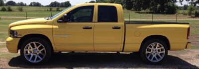

I have them on the rear of my quad cab 4wd. I can't really tell any difference in ride quality over the stock springs. Originally had 2" shackes, but I added 2" drop spindles/knuckles on the front and wanted a little more in the rear so I swapped out the springs to the 3" Bell Tech and installed the stock shackles back on.

Great thank you! Do you have any pics of your truck as it sits now? Have you noticed any difference in handling or axle wrap/wheel hop?

Here's a pic of it. I don't have any axle wrap or wheel hop, if it starts to spin it just blows the tires off like normal, nothing extra going on. Rides as good or better than stock, but the most I've pulled with it is a 19' jetboat with a BBC on a tandem trailer. No complaints. Shackles were easier to install by far though without a second set of hands. I have my 2" drop shackles laying around if anyone wants those to try first. truck.jpg

Looks great! Appears to be quite a bit lower (more than 1”) that stock leaves with 2” drop shackles. Would you mind measuring distance from ground to top of wheel well front & rear?
I have stock height front with 2” rear shackles, and wonder if the belltechs with stock shackles would put the rear noticeably lower than a stock height front suspension.

Thanks. I’ll measure them as soon as I can. Probably in the morning. Most people don’t realize it’s actually a 4wd anymore.
