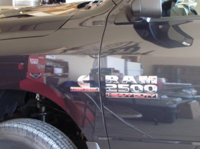

Before / After, Thanks for the video Trup.
