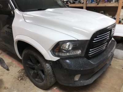

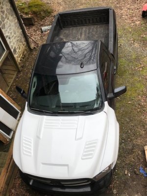

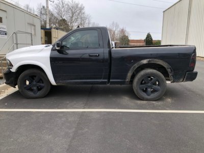

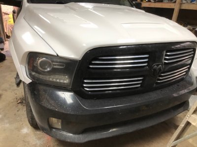

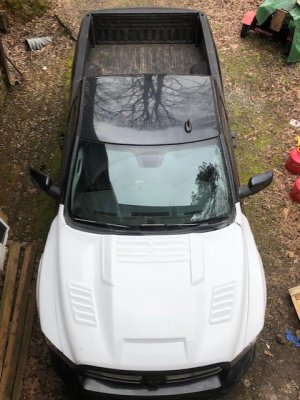

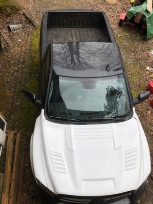

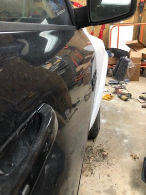

Got the other front side on along with the hood & headlight extension this morning. I'm liking the way it's going to look when completed.
View attachment 239207 View attachment 239208 View attachment 239209 View attachment 239210
Thanks!Turning out really nice
Thanks! That's good advice. One thing I will point out about the install is when you install the fenders first to fit the stock hood is the back of the hood hits. So I trimmed the drivers side to clear. Bad move. I left the passengers side alone even though it was rubbing. When I put the hood on, the passengers side was fine. The drivers side will need some work to close the gap.That looks good, just take your time and don't rush it
Thanks!That looks awesome!!
Thanks! Yes, it's an easy fix. The headlight extensions will need some TLC as well.Looking good! I can see the extra gap in the aerial photo when comparing to the other side. Is this something you can fix or body shop?
Im impressed with how good those lines are. Keep the updates coming.Got the other front side on along with the hood & headlight extension this morning. I'm liking the way it's going to look when completed.

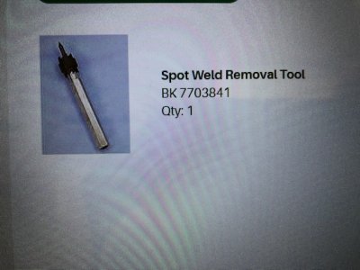

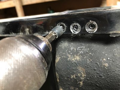

Thanks for the info. I'm going to get another one today. They have flappable cutters so 2 should do the job. I'm going toget several pilot bits as well. Nothing worse than being in the middle of a job and having to go fetch another part.I hate popping spot welds.. though the bit and panel separator bars make a world of difference.
I'd say I get 30-40 spot welds per bit on the 69 Mustang we're restoring. So make sure you have spares.
