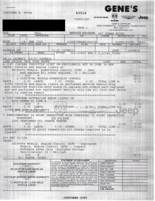

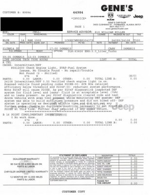

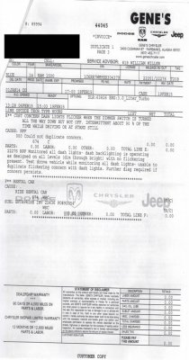

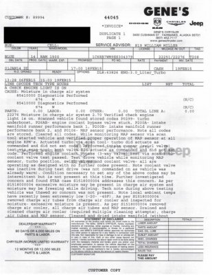

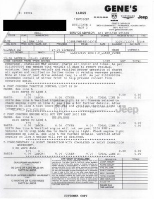

R/Os continued

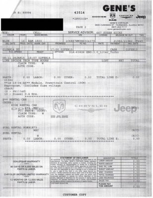

Mr.Asmith9
Mr.Asmith9
Feb 8, 2014
485
145
Fairbanks, AK
2015 Ram 2500 Mega Cab
6.4L V8 Hemi
R/O Continued.

Two new problems,
1. I need to have my EVIC flashed (updated) there is a known issue, which I am experiencing, where the HVAC system gets confused and only blows cold air. It basically thinks that the cab is hotter than any temperature you set the heater to so it will only blow cold air. If your experiencing this issue just turn the heat all the way up and then turn the vehicle off and back on. The EVIC should now show "LOW" now you should be able to actually warm up your cab. Sometimes this takes several restarts.
2. My check engine light is on... again. I think I went a week and a half this time? I need one of those signs that say "X Days since last check engine light." "the best previous record was Y days" I feel like in this case both X and Y would equal 0. Anyway I have an appointment next week, it was actually for the Flash for problem #1 but there going to look at it to while its in.
Mr.Asmith9
Mr.Asmith9
Feb 8, 2014
485
145
Fairbanks, AK
6.4L V8 Hemi
They pushed my appointment back 2 weeks to April 1st, they've had my truck since then I'm currently in a rental waiting for any information and I'll update any of the followers I still have when I know more.

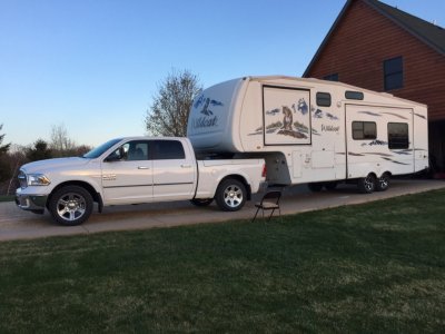

Very well done Mr.Asmith on your write up on the Alaska trip !!
As for the towing ability - I am about to find out with double the weight
Camper 10,500 lbs - trip is 2 weeks long all in the mountains of Colorado.
Laramie Limited - loaded - I will upload a picture of the rig and be back with the report in Mid June.:favorites13:

What does your door sticker say for payload capacity? You're probably going to be way over with that trailer.
