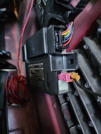

Hey guys I need a little bit of help
To day I was doing the conversation on my 2014 ram, and when I pulled the back seat out and the kick panel I noticed that my rf hub and an additional connector going to the lower right side of the hub, so I decided to kinda of ignore it and continue on and when I got to the programming part. When I tried to program the fob to the rf hub it asked for a 5 digit pin, but I only got a 4 digit pin from the chrysler pin puller app. And now I don't know what to do. Did I get the wrong hub? Or is my pin only 4 due to that fact the I assume Is a internal antenna in the hub? I need some help
The picture below is also the hub with the extra cable in it
See post 1,953.
