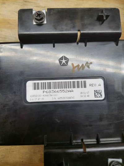

May 28, 2016
60
32
Springfield, Mo
Curious if there are different SW versions, or revisions for the '552AA module. I tried the attached ( bought used on ebay) and saw the same response as the original module. 45e1ff79cea81abf7dc4bbafea32ca0e.jpg
Mpgrimm2
Mar 30, 2014
6,105
4,193
2022 Ram 1500 (5th Gen)
Have you tried disconnecting the battery for a minute or so to force the radio and modules to reset? (It will take a good while for the radio to reset fully, ie backup cam and SXM will be missing until it's finished reading the BCM config.)

ckleinfeld
May 28, 2016
60
32
Springfield, Mo
I did not, thank you for the pointer. I'll give it a shot this evening.

ckleinfeld
May 28, 2016
60
32
Springfield, Mo
Let us know how it goes.
Side note: Back when the Single Zone ATC mod was first figured out on the 13-17 trucks several people noticed differences with the settings/features when getting used HVAC modules (from higher trim trucks) vs new ones without any saved BCM config in them.
M² Mods.
No luck. Left the battery disconnected for ~45 min. Radio reset, lost Sirius and booted with dual zone climate control. Key cycled; XM and single zone climate control returned, assuming it read the BCM fine. On-screen temperature slider was still not calibrated to the mixing door position. Full hot is close, within 5°, but full cold falls short by ~20°.
Not the biggest deal, certainly something I can work around. Just annoying
