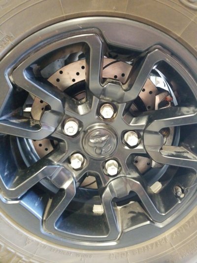

so I ordered all the pieces last weekend July 1st
discs pads and calipers from autoshack.ca
first time ordering from this place for me and now that I have seen the quality I will highly reccomend them to my Canadian rammers! free shipping to most places in Canada and the price cant be beat for what you get. I got the performance rear kit; drilled and slotted powder coat black surfaces, real sharp looking, I hate to see rusty rotors lol
comes with their performance "ceramic" pads but I saw something that looked alot like bits of the forbidden copper but hey Im no friction engineer I wont tell the government :patriot:
even left and right directional discs I am really satisfied so far
thats the good part
ordered the parking brake shoes from Canadian tire along with some permatex orange ceramic brake grease and 1 litre of dot3 brake oil
they didn't have the shoes in stock they were supposed to ship them to my local store then i pick it all up in 3 to 4 days
well the shoes never came in by Saturday when I went to pick up

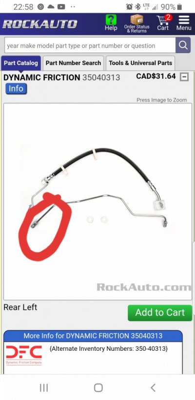

the brake hose I ordered on Amazon after I posted this thread here delivered to my place was a nice quality reboxed sunsong piece with the rubber part and the metal line going up to the junction
it looked like a perfect fit and I was happy that it came with the metal part because other ones I looked at didnt come with that part and people said they had to cut and flare the original metal part because from the factory its a one piece metal line rubber hose combo
every piece looked good yesterday afternoon so I dove into the rear brakes
when I took apart the rear drivers (problem zone) this time the caliper was completely stuck. even when I took off the hose and put it on the bench and used my big pipe pliers it did not budge
so I was happy to have new calipers!
stripped both sides down to the parking brakes. excellent condition cleaned and lubed and lightly sandpapered the friction surfaces
discs pads calipers everything going great saved the hose for last just before brake bleed

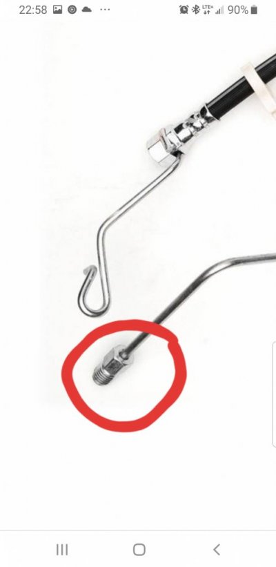

unscrew it all up to the junction on the frame
go to install new metal line, realize the fitting on the new line is wrong, must be a standard instead of a metric :favorites68:
Saturday after 5 pm all parts stores and Canadian tires are closed
dont have a flare kit nor the proper fittings
so no choice had to reinstall the old line and get the thing off the jackstands and out the garage lol
let both calipers gravity bleed a good bit and then proceed to bleed as normal. everything went perfect even on the rear drivers side
I was suprised that it went well and it drives fine and doesn't grab so far
monday though I will bring the line to someone that can change the fitting for me
according to my Google-fu the fitting should be m12x1.0
the wrench I used was a 12mm and the threads were fine so seems logic
can anyone confirm?
thanks!
