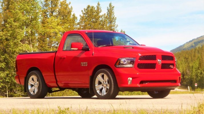

If you're spinning hard on launch,you'll want to do the "cut" relocation brackets. They bring the rear arms back to where they start to apply some body seperation to force the rear tires into the ground and create some body seperation.If you look close you can see them in these pics.These are the older Illicit brackets on mine,and with them,the truck will hook on a skating rink.
