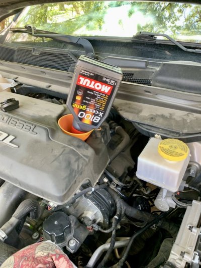

I did my first oil change on my 2020 ram eco-diesel. I immediately got random low oil pressure warnings. The filter I used was Mopar OEM 68507598AA. Based on another forum post, I took it off, threw it away, and put one on from the dealership. Now, everything is OK!

Those ED's take a very specific oil with specific additives. Hope you used the right oil.

Welcome to the world of counterfeit parts!

Let me guess, you bought the filter off of Amazon.
I ask because it's going around bigtime. I posted somewhere around the forum about the rear fuel filter counterfeit and what to look for. I've also seen alot of Motorcraft parts counterfeit. some parts not so obvious but if the price is too good to be true...... well.. you know the rest.

Have you contacted them and have they responded? I get filters from them now & then.

According to Motul oil web site below, that 5w40 oil only has an API rating of SN.

I guess you missed the fact that he was putting API SN oil in an ECO Diesel engine that requires API CK-4/CJ-4 oil...
