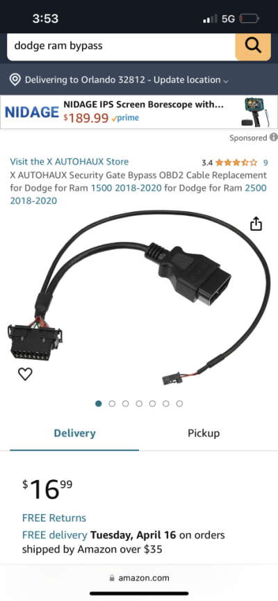

I have a 2019 dodge ram classic. I was wondering if anybody has used the the gateway bypass cable off of Amazon for 20 bucks? I notice it only has one lead plug, and a bunch of videos I see online have two lead plugs. I know I shouldn’t order parts off of Amazon, but it says it could be here by tomorrow and I’m working on a short timeframe. Please any information would be super helpful.

Hey Dean, appreciate the quick response. I’m trying to update my mileage and engine hours. You don’t think it would work? I’m using alfaobd.

This is the best solution for a security bypass cable.
I believe that there is a less expensive bypass cable assembly available from Amazon that is suitable/compatible with Gen 5 trucks.
Unlike the assembly that you purchased, it has 3 connectors and allows for a physical bypass of the Security Gateway Module. The problem is that not all of them work properly and you may be gambling on getting a functional bypass assembly.
I believe that you also must remove that type of bypass for a dealer to be able to use the OBDii port.
The KaodTech is 100% reliable for Gen 4 or 5. I have one permanently installed, the dealer can still use the OBDii connection without any problems.
AFAIK, shipping in the US is included, you can always contact them to ask about any additional costs to rush the delivery.

I used the Single connectorOne on my 2023 Ram 1500 classic. It seemed to work fine, and there's only one Bank to connect to anyway so I wouldn't know what to do with this second connector if I had one. I'm having trouble getting my OBD2 to change configuration but I don't think it has anything to do with the security bypass. I ordered a better interface.

IIRC, with the Kaotech, there are 2 types a single connector (1500) and the dual connector(2500).
I would imagine this is the same for all bypasses. Thinking that the OP has one for the 1500
The single connector is white and the dual has white and green plugs. The green connector goes in the white block and the white connector goes in the green block
