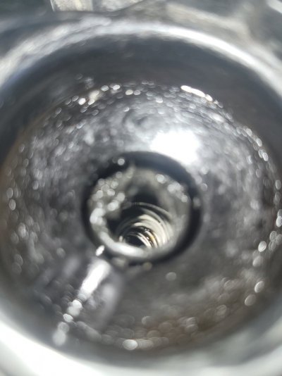

I did te same thing just before a trip to Florida last week. I didn't have the time to work on it before leaving and noticed the occasion puff of black smoke from the exhaust on the trip down. Once I got there, I was able to remove the copper plug from the broken valve with a small set of bent nose pliers and use a #5 extractor (EZ out) to get the broken tube out of the housing. All in all it took about 5 minutes.
I did run some Cataclean through it afterwards and never experienced the black smoke since.

How was you able to get a drill in there to use an easy out? My 08 I don't have room
