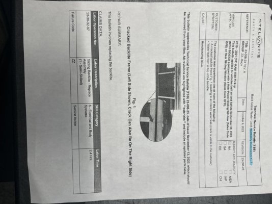

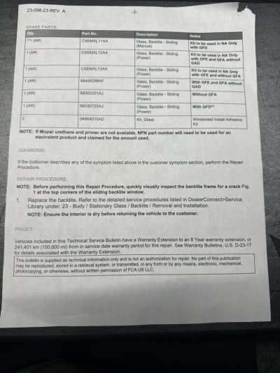

I figured I'd just make a new thread rather than try to update existing threads on this. For 2019, 2020, and some 2021 1500's (DT) Stellantis is extending the warranty on the 3rd brake light and rear windows that suffer from water intrusion. Here are the TSB's...
