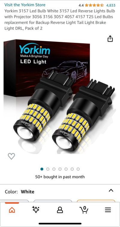

Would you happen to know which ones in particular you're in the tail using from Amazon? I swapped the bulbs and socket to FINALLY get rid of the error. My wife has forbid me from more mods to the truck, BUT it bothers me that those are still halogen bulbs in the tail lights.
My tail lights use a 3157 halogen bulb. I replaced them with Yorkim 3157 LED bulb in white. Currently $12.99 for a pair on Amazon.
Should use red LEDs behind red lenses. Also, found out through using several cheaper 3157s that eventually you'll lose a few leds on the bulb and still trigger bulb out warnings. Just something to stay aware of.

I use white bulbs in the 3157 group. Something about the frequency of the light spectrum makes them more intense. My daughter was an engineering student at the time of my purchase and explained it to me. Her explanation was over my head but was good to know my tuition payments to Virginia Tech actually went to something useful. LOL
