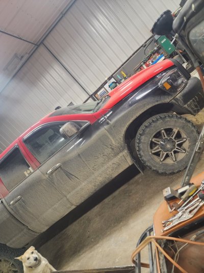

Motor recently went Kapoot in my 07 dodge ram I have a line on a 2004 motor but I know that they did not have MDS will this cause a problem with the swap or will I just need a tune afterwards I know you can put a 07 into a 04 but does it work vice versa?
What all will I need for this swap or am I better off finding a 07 MDS engine to put in
