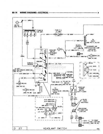

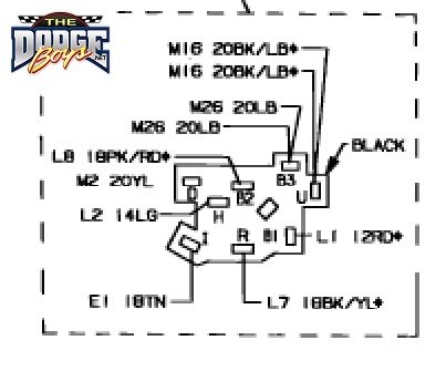

Yeah, a test light goings to be your friend here. Here's an '87 schematic, pretty sure they're the same.
