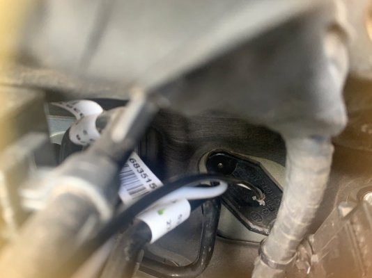

This is the clutch delete plate from under the hood. It's on the driver's side just to the right of the brake booster:

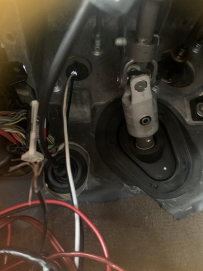

And this is from the inside, looking up from the driver's side footwell.
You'll need to remove the two nuts indicated by the arrows in the picture using the 15mm socket and your choice of u-joints, extensions and ratchet. If you're using a cordless ratchet you'll want to break them loose with the hand ratchet first.
Once you have the nuts off the plate just pulls off from the outside. Due to the length of the bolts and how snugly they fit through their holes, you need to pull it straight out. Mine was trapped under the firewall material at one end (see picture below) so I used a plastic trim removal tool with a curved end to push the material away without damaging it.

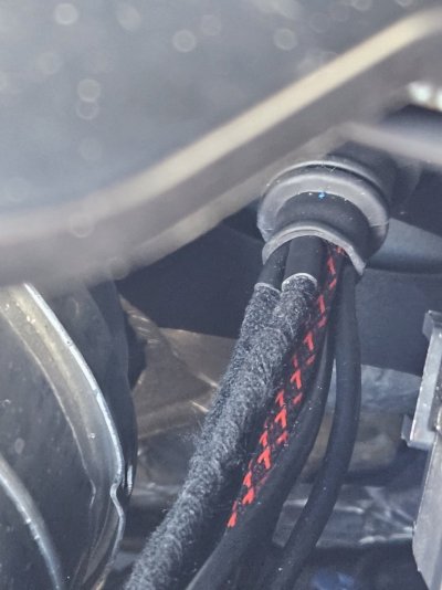

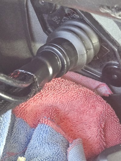

I ended up running a whole lot of wiring through the grommet, using this advice to take advantage of the clutch delete plate.
What I learned working on beaters (though this Power Wagon is like new), always run EXTRA RESERVE WIRE PAIRS so you don't wish u had.
Why have to redo another firewall passthrough later? So now, none of my grommets will have poked holes.
Using this plate allows for a big hole. It could have handled more wires than I even ran through it.
One (1) 10 AWG positive wire for my new under the dash Painless auxiliary fuse block
Two (2) radio coax cables (one for CB and one for GMRS mobile 50 watt).
One (1) AuxBeam control panel wire (about the diameter of a coax).
PLUS: Homemade wire harness with 4 pair of 14 AWG auxiliary/reserve for future use through the firewall = I don't want to do this again for a simple air horn button or something equally stupid.
-----> one reserve pair will be for a PA speaker.
Wires, at the grommet, were coated in between with automotive adhesive, pulled into the grommet from the inside (goop in grommet), then I slid on heat shrink sleeve over it all. Heated and shrunk it to make it water resistant and near water proof.
Remember, when running attached wires from both sides, at the same time (both directions), the heat shrink sleeve needs to be passed through, along with the grommet.
