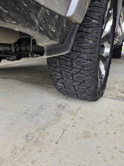

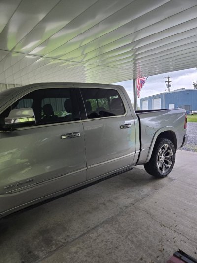

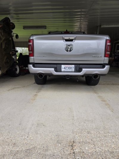

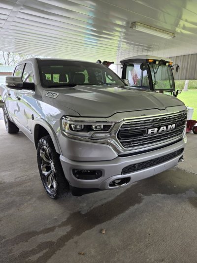

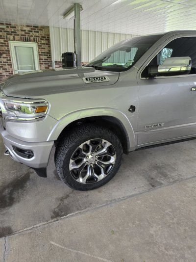

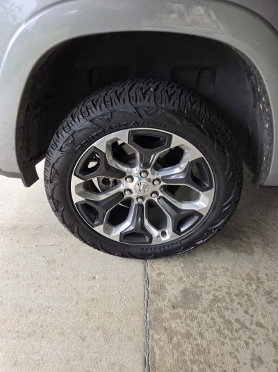

The tire model is Renegade A/T Pro. Tread looks similar to old Dic* Cepek F/C tire, I did not want aggressive only offroad 5% of its life.. Pic of rear right side looks higher than it actually is. Funny ,it will not let me put his name. Added 2 more pics. Had not ever taken pics of this truck for some reason.:893Chainsaw-Smilie-
