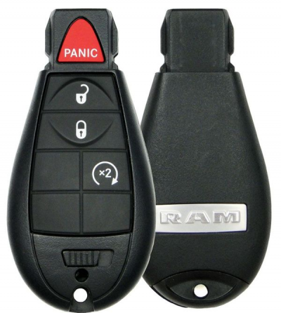

If your son is hard on the tip start fobs, just buy a couple more as spares and program them yourself...I did this on my 2020 Tradesman:
Aupoko GQ4-53T 4 Buttons Keyless Entry Fob, 2 PC Programmable Remote Keys, Replace# 56046955,56046955AG, 56046955AA, 56046955AB, Fits for 2013-2018 Dodge Ram 1500 2500 3500
by Aupoko
Learn more: https://www.amazon.com/dp/B07ZNWYY9W/ref=cm_sw_em_r_mt_dp_adF7FbPCSPZY8?_encoding=UTF8&psc=1
Of course it requires:
1. AnOBDLink MX+ OBD module
2. AlfaOBD software
3. A security bypass harness for 2018+ trucks, but you indicated you have a 2017 so you won’t need it.
The two fobs were $28 on Amazon; the MX+ unit was about $100 and AlfaOBD Full version is $49 for Android devices.
I already had the MX+ and AlfaOBD as I use it in many other mods you can find here on the forum; adding 2 more fobs and resetting the RF Hub took about 10-15 minutes. This procedure is well-documented under the AlfaOBD section of this forum.
BTW...the link to the fobs are for ones with the remote start capability...which I later added with some simple wiring and using AlfaOBD.

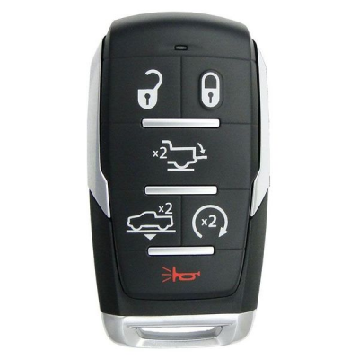

Anyone know what the 6th button on the Keyless is for??? I have the Rebel, so I have Remote Start, and I can drop the air ride from the fob, plus the standard lock/unlock/scare the **** out of the 2 year old when you fat finger the panic button at the store and the cart is next to the driver wheel (panic button)...
But I keep looking at #6 thinking "What the duck is this meant for??? And can I use it for whatever that is?" I have the solder pads, and traces, but no button, which I can fix if it does anything.

The only example I could find with all 6 buttons used was for a mini-van with the bottom two being for the power sliding doors.

2022 Dodge Ram 1500 Smart Remote Key Fob w/Air Suspension, Remote Start, Power Tailgate​
