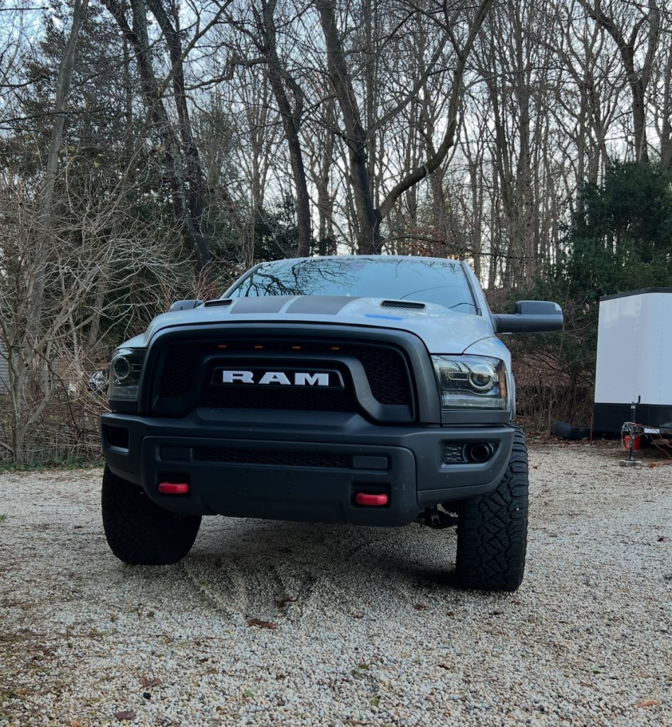

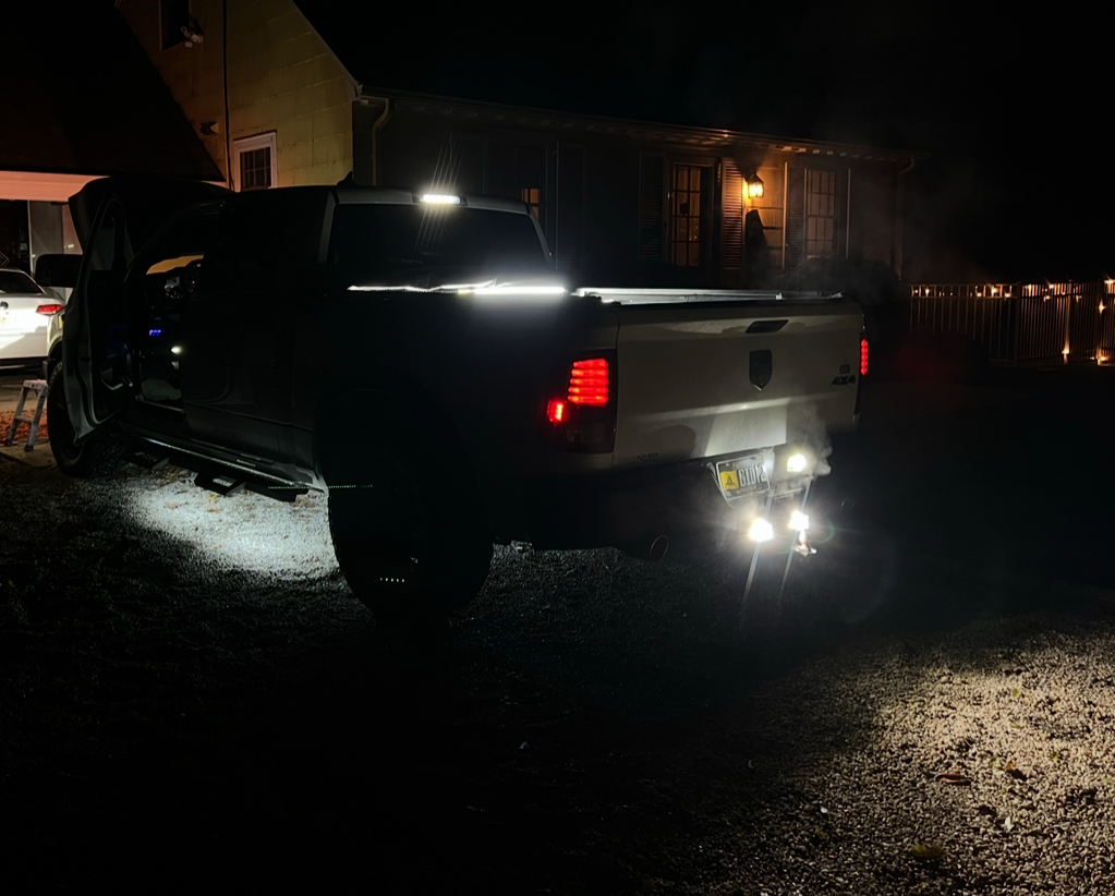

As of now she’s got:
- Cheapo Sailun Terramax RT 35” winter tires
- Upgraded all stock Halogen bulbs to LEDs (highs/lows, dome light, map light, footwell lights, vanity lights)
- Swapped to OEM Tow Mirrors
- Aftermarket rear bumper
- Added OEM Fog Lights & bezels
- Added OEM Tow hooks & bezels
- Added RAM emblem LED & amber grill DRLs
- Hitch mounted reverse/work pod lights (absolute godsend for hooking up my tool trailer)
- Truxedo tonneau cover
- Ceramic Tinted side & rear windows
- HDX running boards
- Sub amplifier & power cap
- Rockford Punch speakers

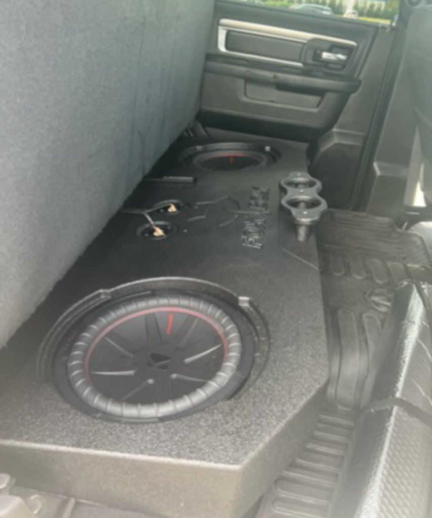

- Fox sub box with dual 12” Kicker subs

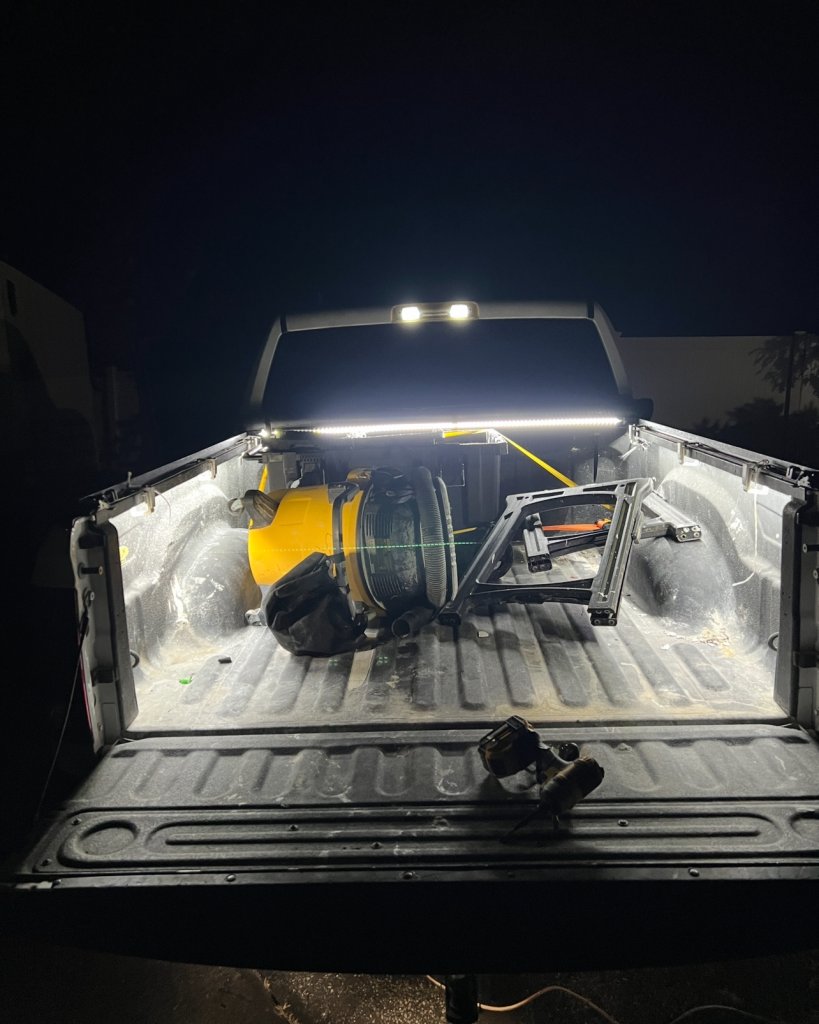

- Bed cargo/work lighting triggered by in bed switch
- Black LED third break light
- Auxbeam switch panel & fuse box
- Running board mounted LED courtesy/approach lights triggered by door open/unlock button
- LineX bedliner

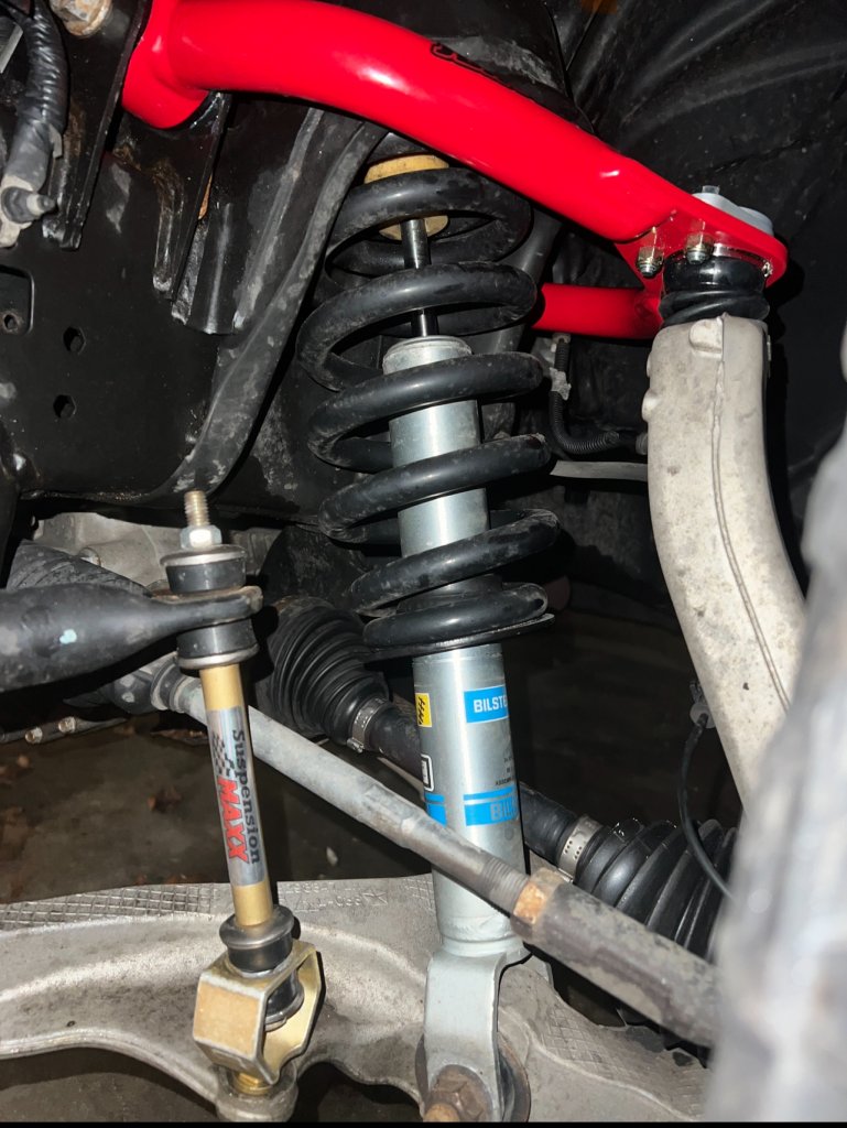

- Bilstein 5100 Front Coilovers (2.1” Level)
- Bilstein B8 Rear Shocks & HD Lift Coils
- Airlift Loadlifter Ultimate 5000 Bags routed to license plate
- Alpharex LUXX Tail Lights
- Billet Tech Catch Can
- Moes Performance 87MM Ported Throttle Body
- K&N Breather Vent Filter (deleted intake-routed breather line)
- 6.4L Lower Airbox & Airduct upgrade
- Carven Progressive Exhaust w/ 5” Black ceramic exhaust tips
- Peddle Commander throttle controller
- Diablosport Pulsar set to Performance mode running 93. (Shouldve gotten an unlocked PCM & custom tune. I’m LOVING the Pulsar it’s so much fun but financially regret going this route as a custom tune would’ve done me better in the long run.)
- Caulk06’s ZF 8HP70 Transmission Thermostat Bypass Valve
- Legmaker Carbon Fiber intake “Mid” Tube
- Black lugs, stock 20” wheels
- BORA 1.5” hubcentric wheel spacers
- Suspension Maxx HD Extended Front Sway Bar end links
- Core 4x4 (Track) Rear Upper & Lower Control Arms, Track Bar & Rear Sway Bar End Links
- Roadmaster Heavy Duty Rear Anti-Sway Bar
- PPE Heavy Duty Aluminum Cast Transmission Pan
- Bulletproof 6” Drop Hitch
- Redline fluids throughout
Eyeballing the Powerstop Z36 full break kit & 6.4L intake manifold swap next. Possibly JBA UCAs but I don’t know that I need them just yet.

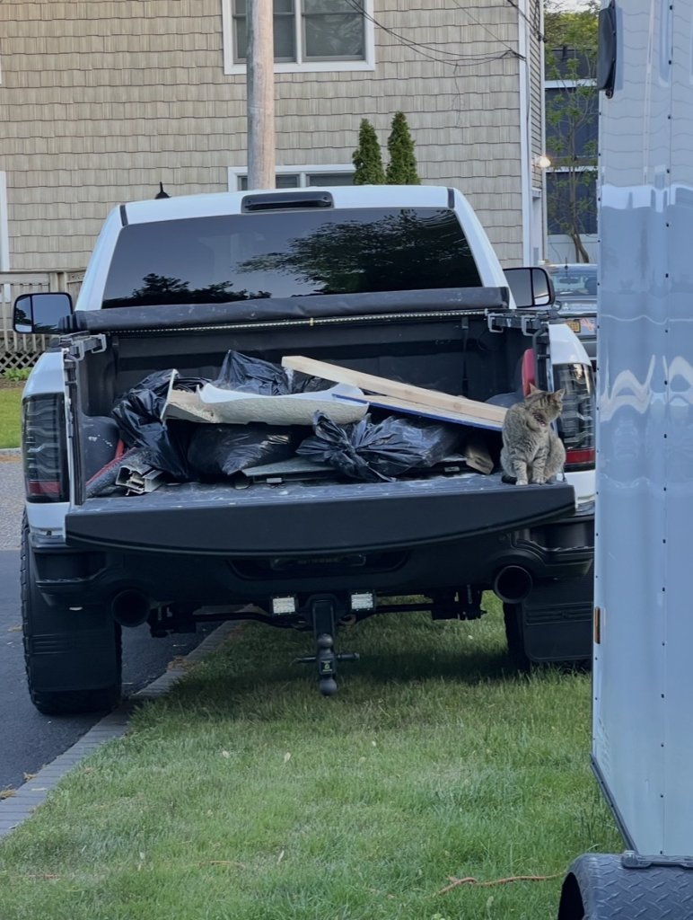

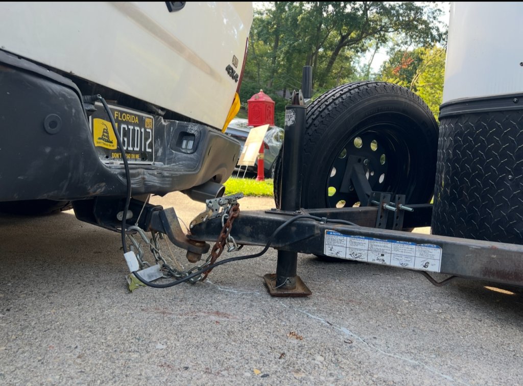

Stock first break job a couple years back. Prepping for a straight shot trip moving from Englewood Florida back home to Long Island New York before our daughter was bornIMG_0200.jpeg

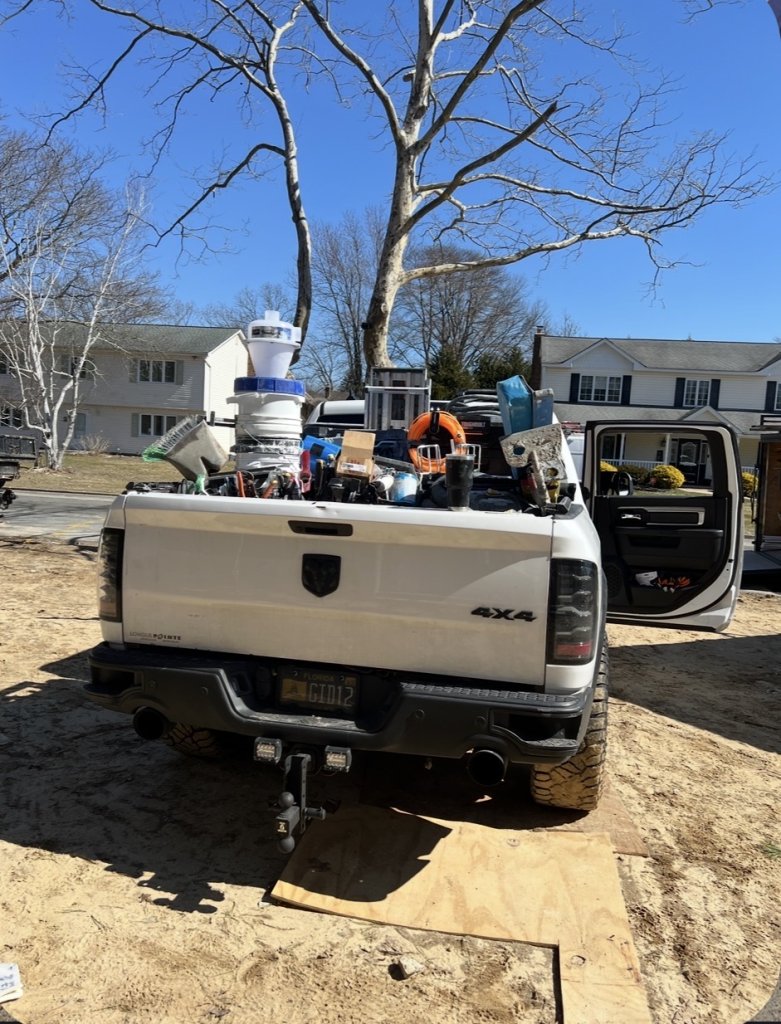

IMG_0208.jpegstock rear suspension was shot. 1500lbs of sand in the bed

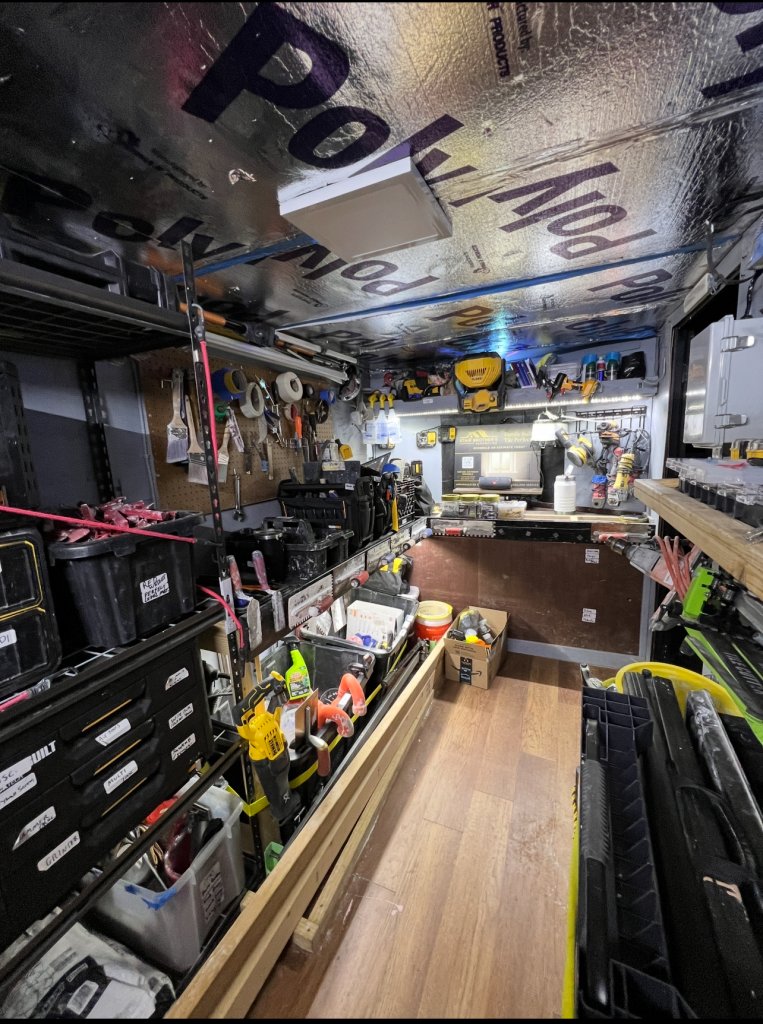

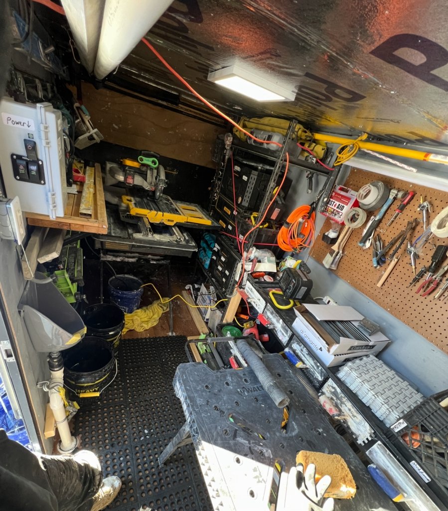

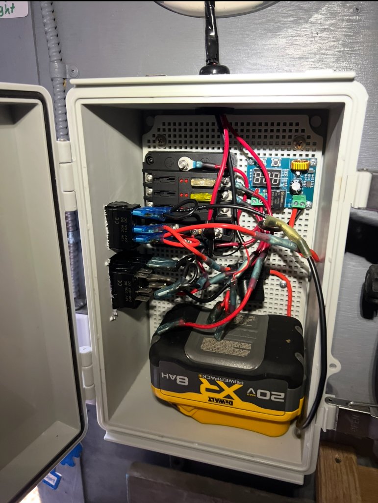

Gotta show the trailer too. Power ran off a dewalt battery attached to 20v-12v RC car power inverter with fuse panel & low voltage disconnect. Shower power connect is at the V nose with breaker box. Shes essentially a portable work station. IMG_0205.jpeg

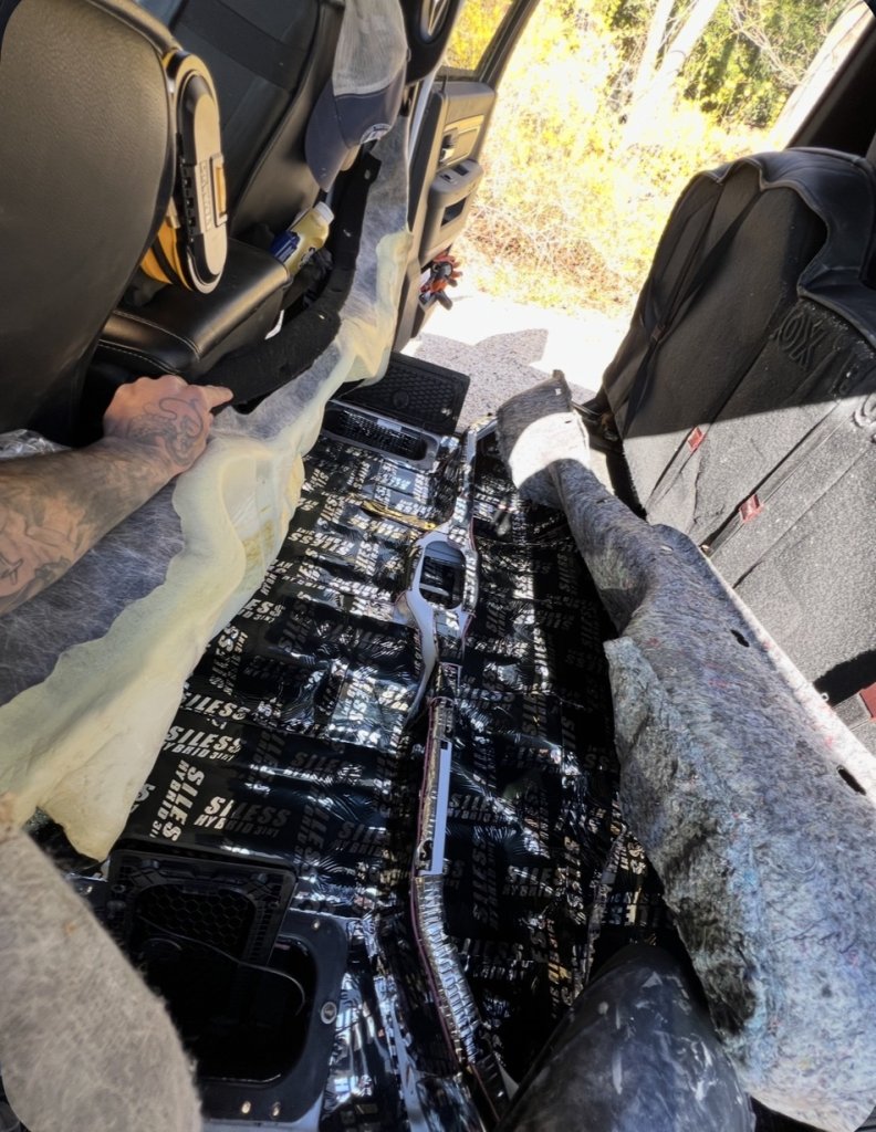

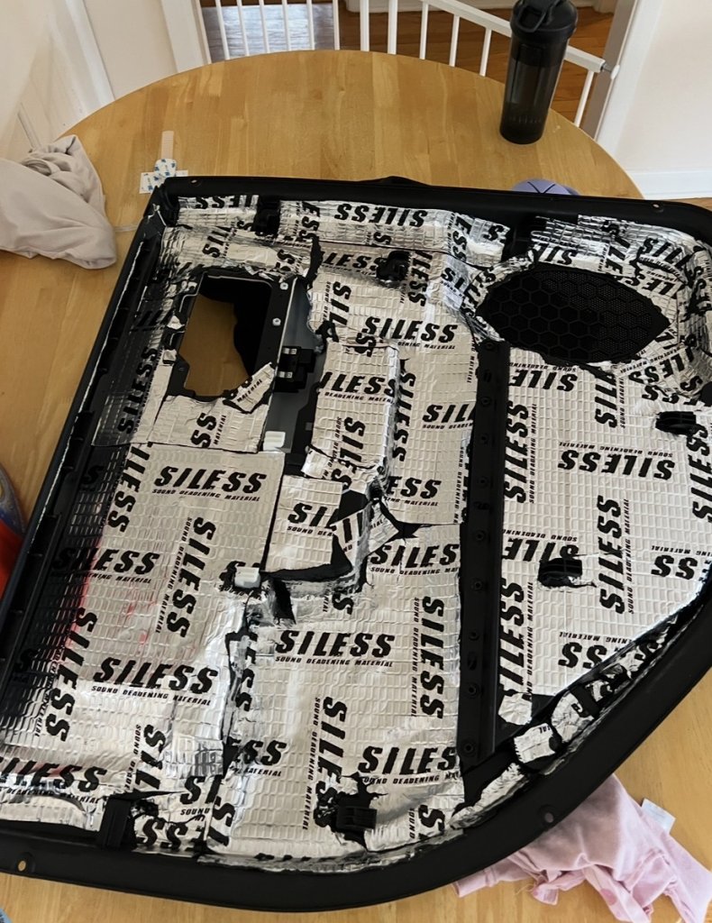

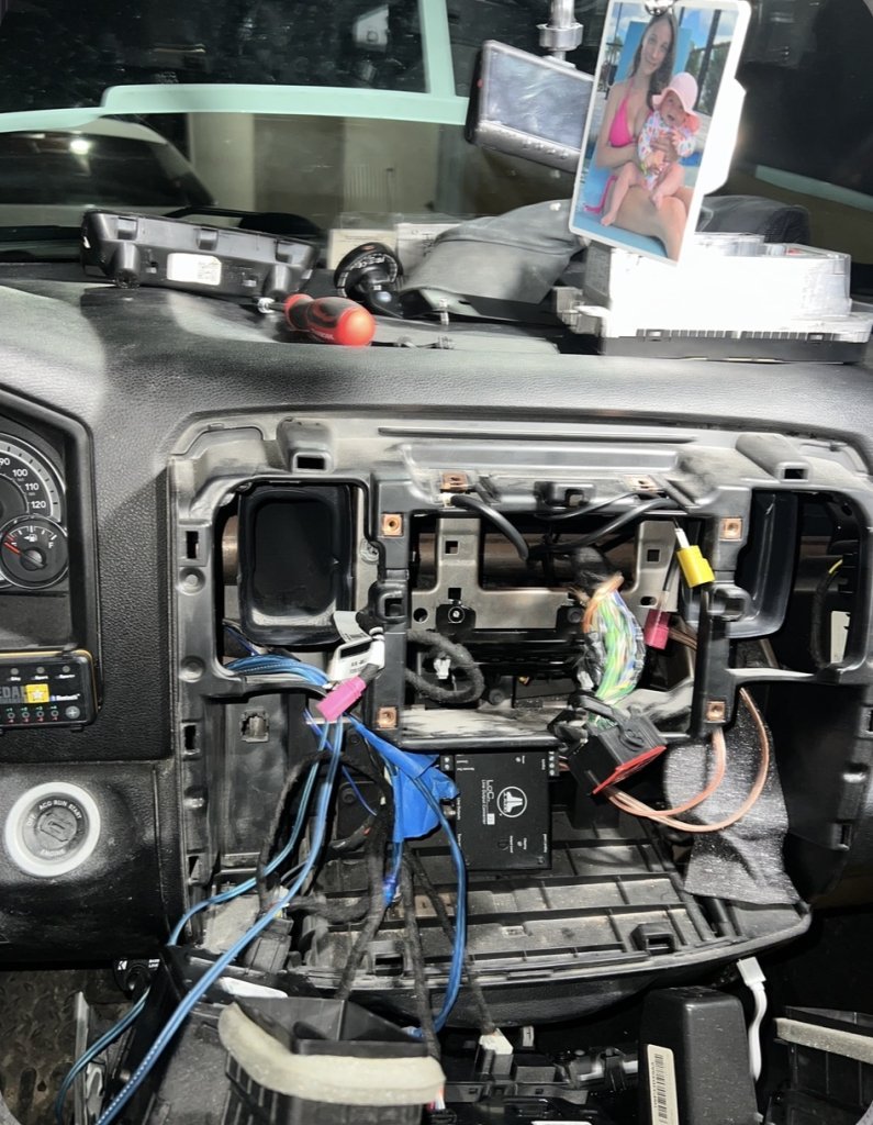

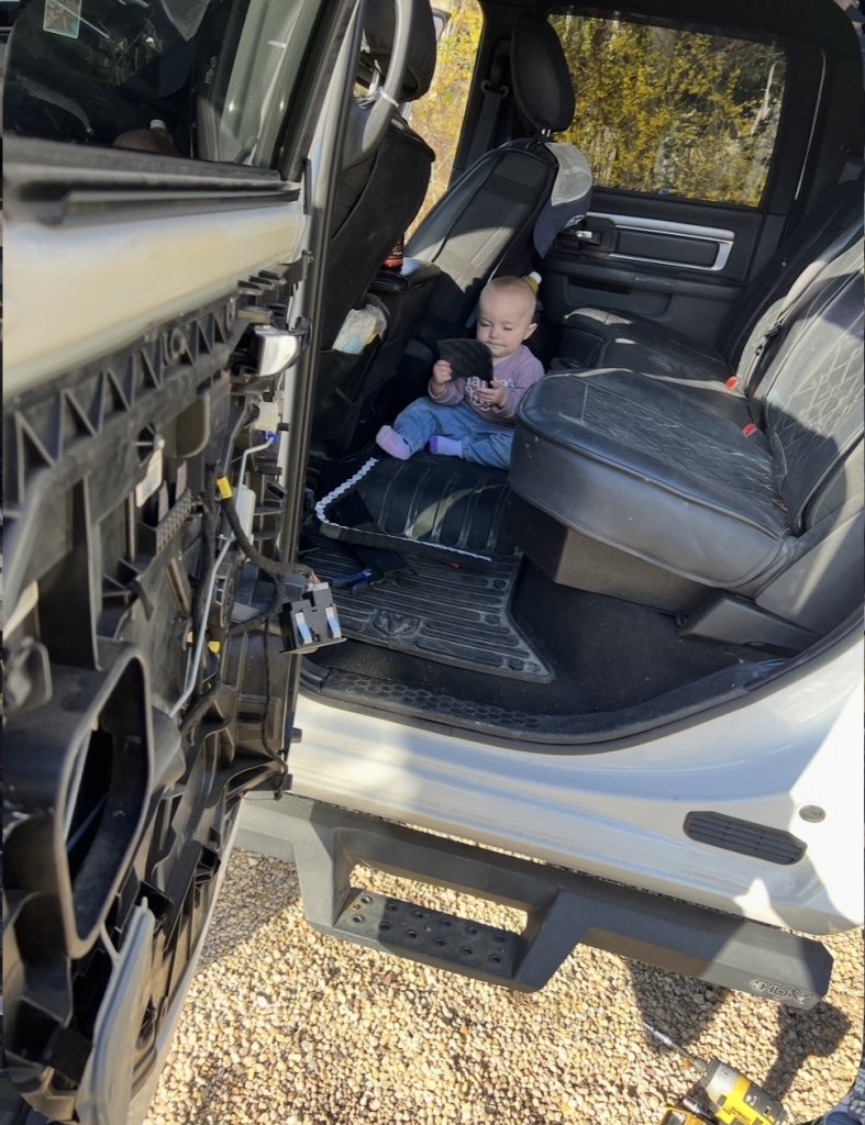

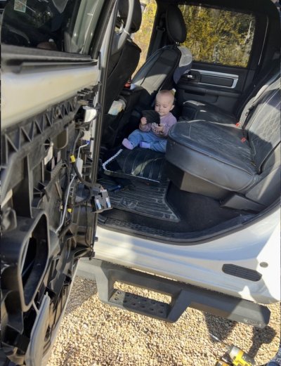

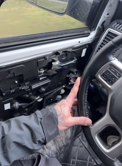

I’m on this website daily and completely forgot I made this thread. Been busy with work and mods lol. Bathroom remodeler/tile guy so my brains fried. Added a JL Audio XDM 400/4 amp to beef up the Rockford punch speakers and bring them up to match the sub power a bit. Through some cheapo Amazon Dynamat knockoff on the entire floor , back wall & doors with the help of my 1 year old daughter lol drove around without door cards on for about a week so I could do one inner (outer? The metal outside-most part.) door each day after work. Will eventually add MLV after I recover a bit from the $ aspect IMG_4501.jpegIMG_4497.jpegIMG_4498.jpegIMG_4496.jpegIMG_4499.jpeg

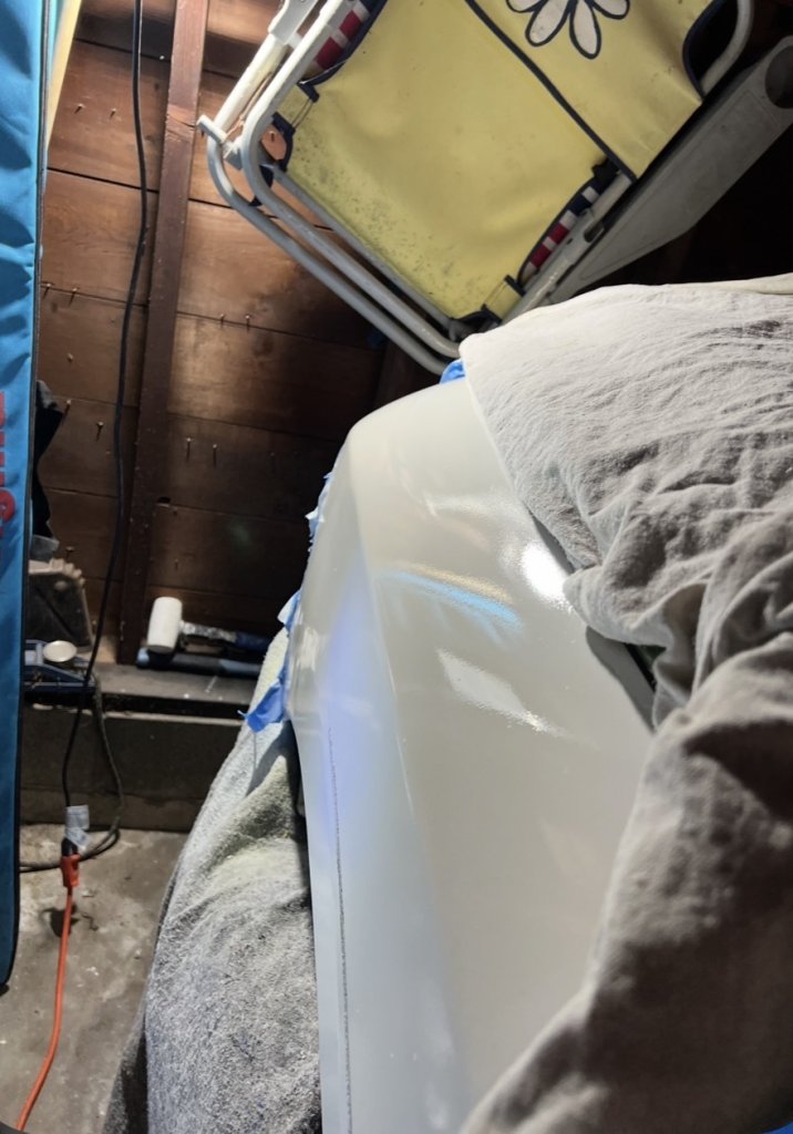

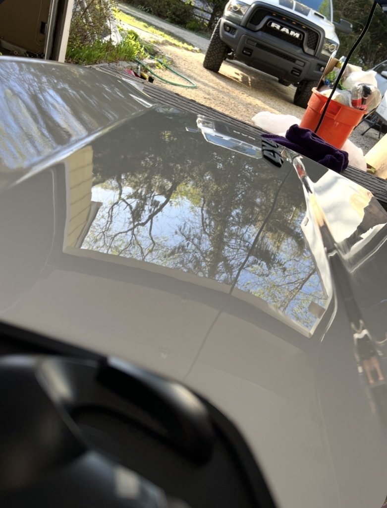

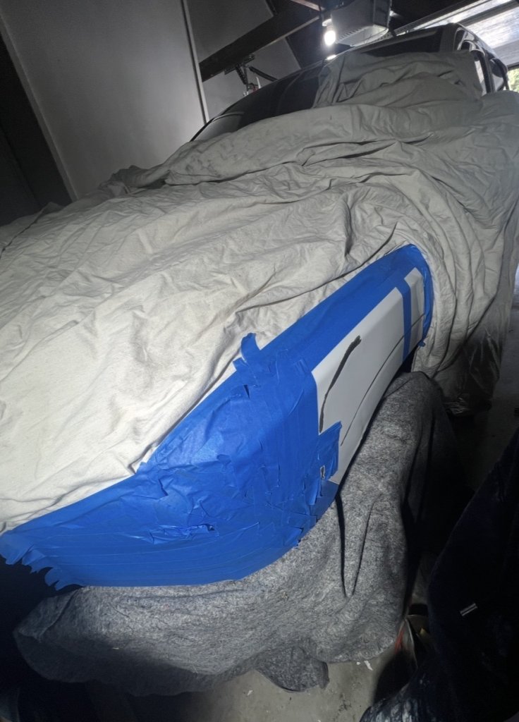

Did some body work, pulled dents, sanded out rust and painted a few panels to undo some of the abuse I’ve put the truck through at work. Wet sanded and did a 2 step paint correction cut & polished the truck top to bottom before I ceramic coated it with Gtechniq Crystal Serum Light. Detailers overhype how hard paint correction is, took a while yeah but not difficult by any means. maybe I’m biased because my truck is white lol. I found it to be very calming. Cant remember the name but bought a “splash and wam-o”? For the tailgate to cover up the trailer jack dent my helper caused last year. Will be pulling off the rear bumper to hit a few spots I can’t reach with the bumper on once I get some more time on my hands IMG_4500.jpegIMG_4502.jpegIMG_4503.jpegIMG_4505.jpegIMG_4504.jpeg

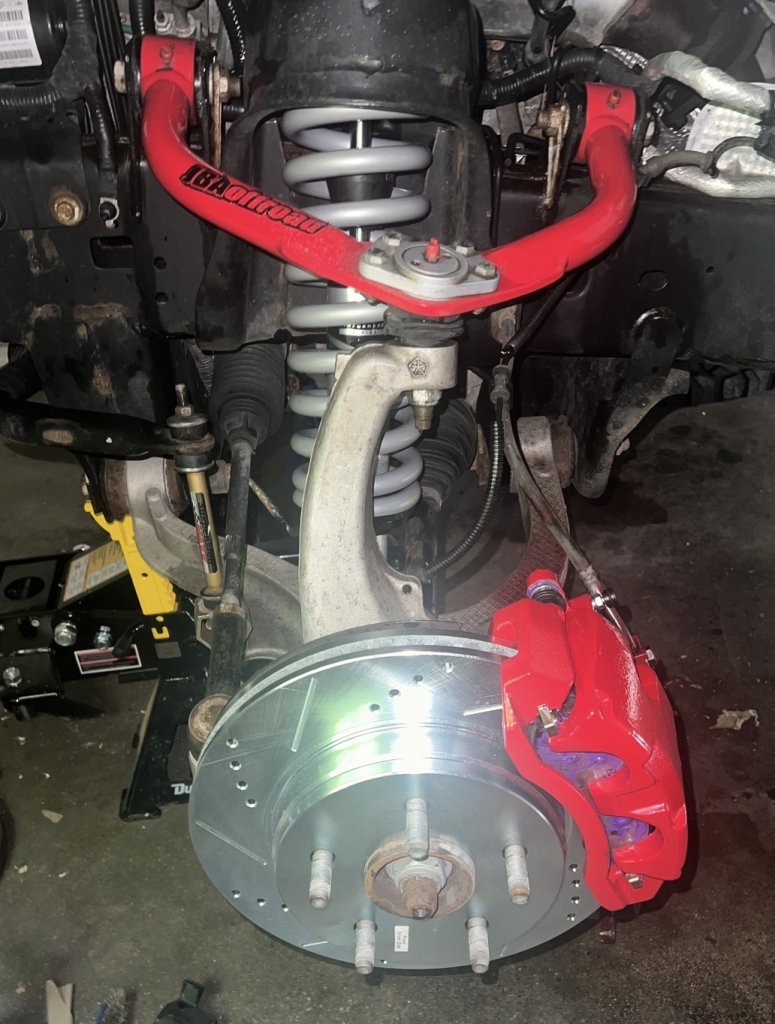

1. Powerstop V36 calipers pads & rotors, just got here today

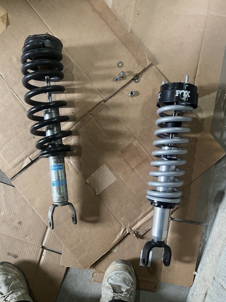

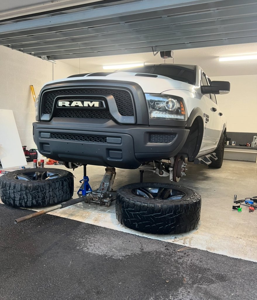

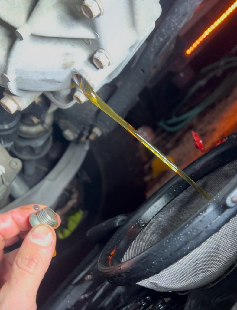

Out with the old in with the new! So happy to get these garbage teeth-shatteringly stiff Bilstein 5100’s off of my truck. Absolutely horrible ride quality. I guess they must feel nice to guys used to driving unloaded 2500’s or fords (lol) but they were miserable from the day I put them on. I can maybe see the appeal of them for southern drivers with perfect roads driving 30mph all day but they’re not meant for the horribly congested “pothole-wasteland” that is Long Island New York lol. My wife HATED the bilstein’s and made sure I didn’t forget every time she was in the passenger seat.IMG_4577.jpegsnapped 2 top bolts on each shock taking them off with little to no force. Kind of freaked me out imagining what could’ve happened if I kept them on. They were on the truck for LESS THAN 6 MONTHS. Anyways, I’m excited to take these fox 2.0 performance series for a ride tomorrow to break-in the new brakes.

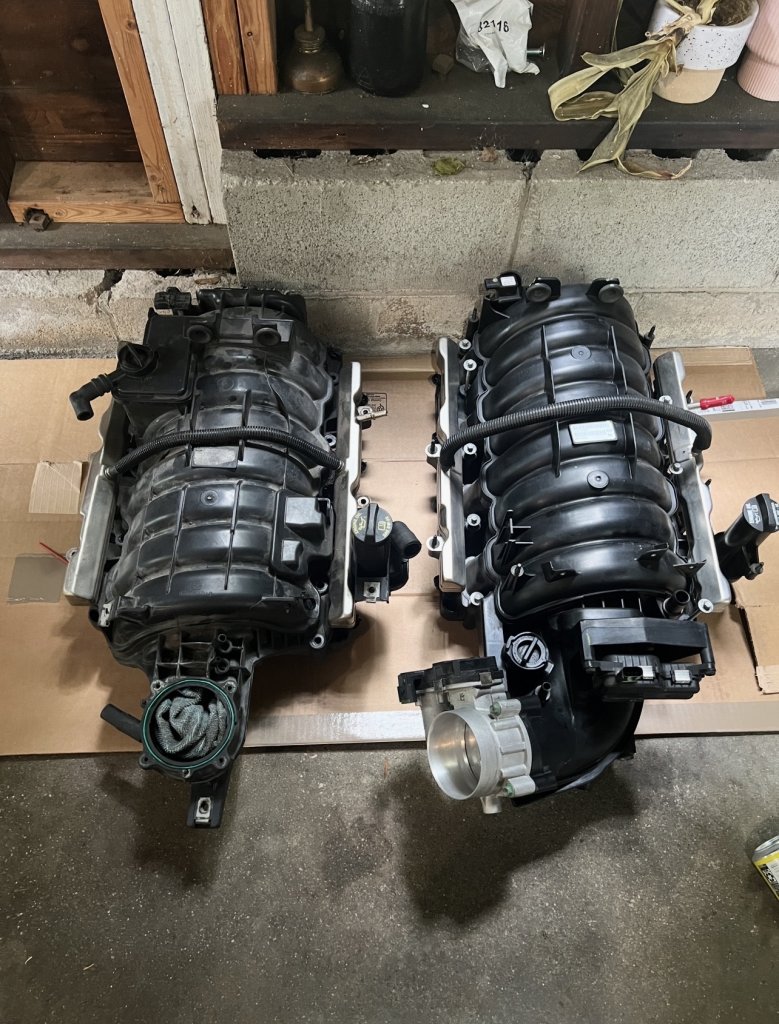

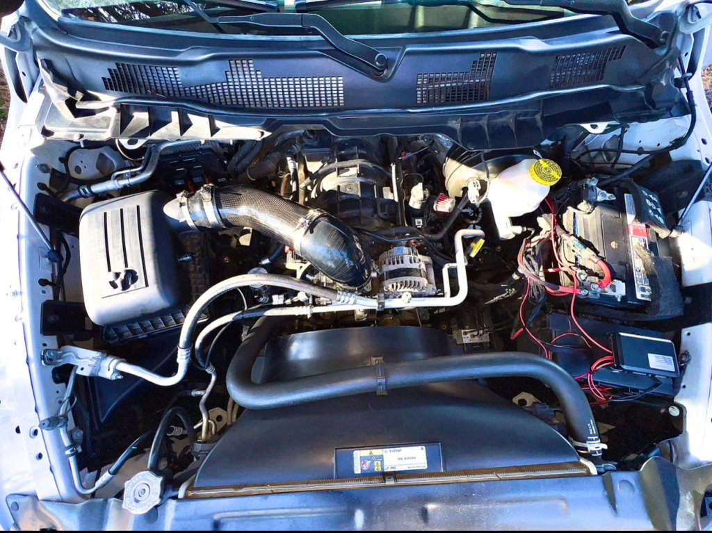

finally did the 6.4 intake manifold swap yesterday, paired with an air box from a 6.4 since I already had it from running the lower box.

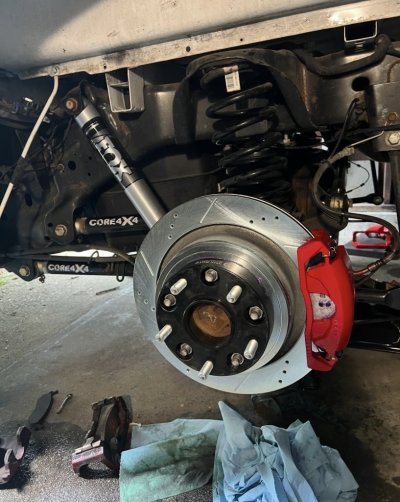

Wrapped up the rear today. Foxes ride fantastic I’m very happy with them they’re exactly the feel I wanted. I’m pretty disappointed that they come shipped with no lift they’re advertised as 2” lift coils but my truck is sitting 2” lower than it did with the Bils. My dumba s s forgot to check so now I’ll be riding around with the factory rake until the weekend

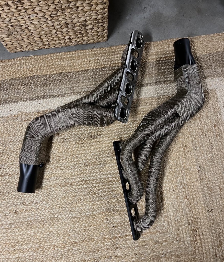

Coated, wrapped, silicone sprayed and cured. Let’s get it ! Got the old manifolds off earlier today, currently fighting with the Y-pipe clamp will post pics shortly

Got the headers in last weekend forgot to update since it ended up turning into an all nighter followed by taking 2 days off of work install wasn’t bad, I cracked them fought with the dipstick for almost 8 hours but eventually got it out. Truck sounds mean and finally got my Hemifever tune and it runs like a dream.
Still getting used to how it drives compared to pre-long tubes w/ a canned tune. Felt much tighter & instant response pre long tubes, but GOD DA M N does she book it now. Bogs down a tiny bit before it actually goes could just be the new PCM as the tune is fresh.
10mm stubby swivel socket, flex head ratcheting wrench and a set of stubby wrenches are your best friends used both 3/8” & 1/4” . Very very tight on most of the bolts and I have a set of baseball mitts for hands which didn’t help. Not a mechanic by any means but I’m very good at figuring sh’t out & got a decent set of tools on hand lol. Going to replace the SW clamps that came with the kit out with band clamps soon.
