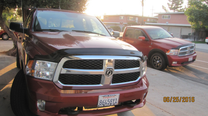

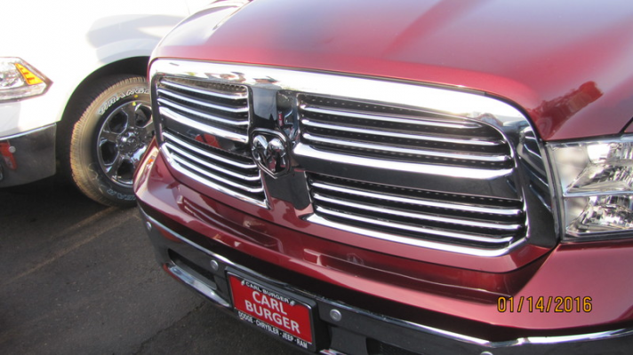

without measuring, the difference that i see between the 2009 - 2012 Dodge Ram 1500
& the
2013 - 2018 Ram 1500
is the Grille & upper valance shape
2009 - 2012 look at the lower corners of the grille & the shape of the grille emblem
as well as the horizontal fog lights
2013 -2018, cut off lower corners & cut off emblem
vertical fog lights
Heavy duty Ram changed some features a year later (2014)
Although the fog lights remained Horizontal

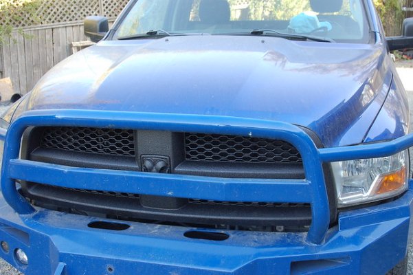

2500 bumpers wont fit 1500's. You looking for oem type stuff or ranch hand? You see the headlights, on the 2500 it is straight across and not raised off bumper line. see the bumper line on the top of the bumper, 2500 straight across...
Burla
Apr 28, 2012
23,624
46,138
2010 Hemi Reg Cab 4x4
On 1500's you see bottom of the headlights..

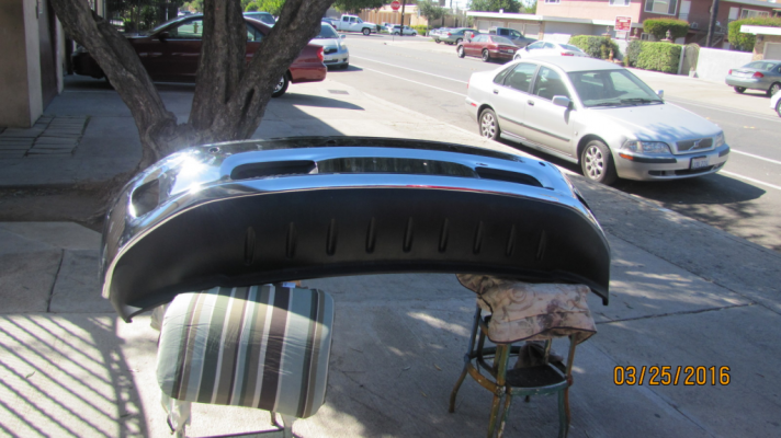

I have a 2013 - 2018 Front Chrome Bumper
It is the one with the dealer plate up above

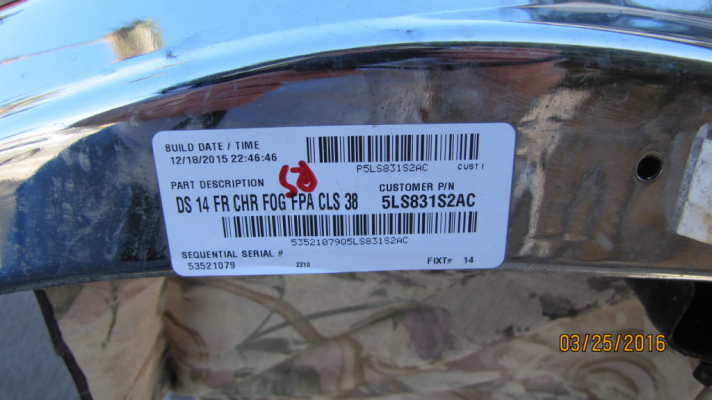

serial number sticker
