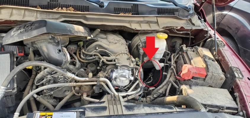

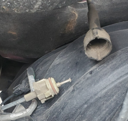

Anyone know what this plug is for? Found it disconnected

One of the cables coming from the plug heads toward the oil pan and the other goes into the driver side firewall. Pics attached, know what it is?

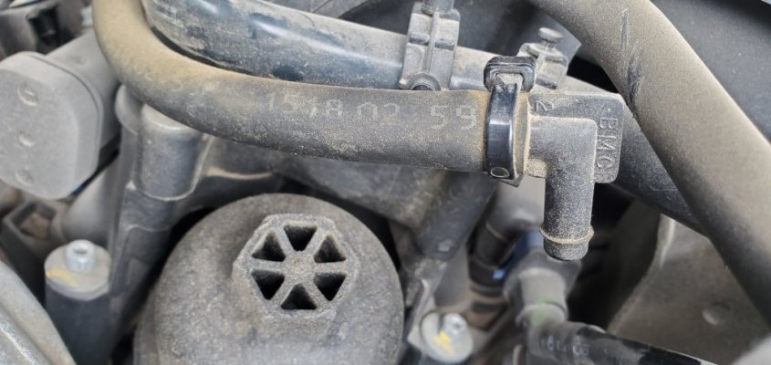

I also noticed a small hose above the engine that is not connected to anything, know what that is too? (pics attached)

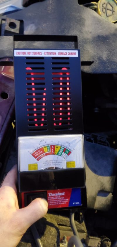

With that many codes,i'd start with load testing the battery.
Buy yourself one of these old school toaster testers,as they're still one of the best battery load testers you can buy,they beat the newer digital testers by a long shot,and at less then 20 bucks it shouldn't bankrupt you.

This hose should be the transmission breather tube
Thank you!
Reconnected the battery after an hour and started it up - no luck. Still the same errors.
The harbor freight near me is out so I'm going to bike to autozone to get this one. Thanks for the advice!

Well, Its not the battery... I just learned how to use a toaster style battery tester from a guy outside O'reilly. I bought a new battery and it measured 11 volts same as my old one. I went in and told the guy I bought it from it was bad and he said its fine you just need to let it run a while. I was skeptical... luckily there was a group of guys working on their cars in the lot. One of the guys with an old F150 checked the new battery with his multimeter and it was 12.5 volts. I tried the new battery in the truck and no improvement. The guy with the old F150 and multimeter helped me trouble shoot and recommended a shop to me that specializes in electrical. And most importantly he showed me how to use the toaster battery tester... you simply connect the cables to read voltage and press the switch to read amps. I was pressing the switch and then looking at the voltage to get 11 volts. So my real voltage on the old battery was 12.5 volts and amps are 800 which is the same as the new battery.

Anyone have a guess what this connector is for?
Based on the dirt it looks like it was unplugged a long time. There's only one wire in it and its a heavy gauge wire with a flange on it, but theres also an o-ring on the connector. It goes from the driver firewall toward the oil pan. The side that goes into the firewall has 4-80 written on it with white marker.
Not sure myself, but it damn sure looks like it goes to that plug ~4" away from it in the first pic, once you clean the crap off of it.
But also likely a cable connection based on your description, not an electrical.
IE like an old throttle cable, or a bicycle brake, not pixies.
I found a tag on the cable its a gearshift control cable

the small hose above the oil filter just hanging out , I have same engine on 2014 ram - smae thing - not connected to anything - and nothing around to connect it to

Follow it back,as odds are it's the breather hose for the transmission,if so,it'll just go to a barbed hose fitting on the top of the transmission.

Those pictures: Pretty sure that's the xmission disconnect cable that is connected to the orange pull strap behind the left panel on the dash. The one used for towing and such.
Someone may have disconnected it under the hood so the orange strap won't work. Kinda like an anti-theft measure.
