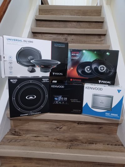

Kenwood Excelon Series components are fantastic.
This is what I had installed in my 19' Classic about six months or so ago, and the improvements are huge.
My truck is my second home as I'm in it a lot for my career in Project Management, and I wanted my music to be detailed, crisp, and have clear loud volume with some bump.
Enjoy your upgrades!

I just install my excelons Components and 6x9 4 way in the rear, sounds amazing with stock radio. I was shocked. Cant wait till I add the amps and sub in a few days.

I started with just the stock head unit and upgraded all six speakers (2 x dash/2 x front doors/2 x rear doors) and it was a fantastic improvement, too.
Wait until you replace the other speakers (if you've not already) and add an amp to the system, and then tune it properly. It's going to be a whole new level of great.
I'd recommend at least 1 x 10" sub as well to give it some kick.
The Audiomobile EVO 2410 sub I have is phenomenal, and specifically designed to fit into small enclosed boxes, and still pound. Just stuff the box with polyfill as it tricks the sub into working like it's in a bigger box, thus getting more drive out of the sub.
