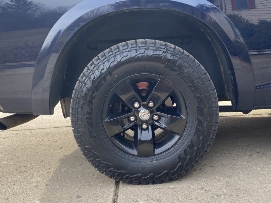

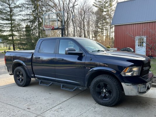

Can’t tell you for sure as I’ve yet to have 285/75s. But if your keeping it stock I think the 285/70s are a good size.
Here’s 285/70 on my outdoorsman which was stock at the time. Outdoorsmans do have an approximately 0.7” lift over other 1500s so it may be a touch higher then yours.

That's a really nice truck man! Seems like the only 285/70's that will fit my narrow rims are LT rated and have no treadlife warranty. Will the LT's wear faster?
I'm really leaning toward the 255/80's because they will fit my rim no problem, and come with a 55k mile treadlife warranty. I just don't want to lose a lot of handling by going to a more narrow tire, and I also don't want it to look weird either..
