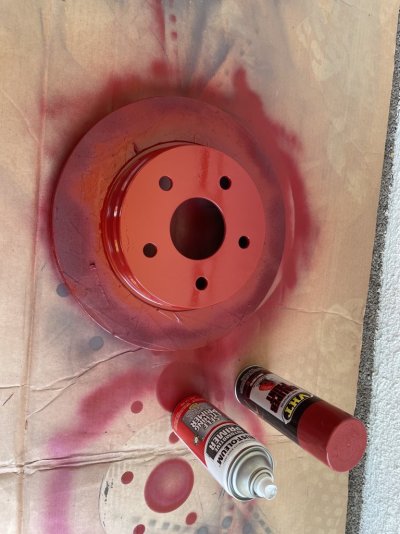

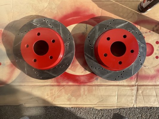

I have a set of Z 36 power stop calipers, rotors and pads. They’re about a year and a half old. Maybe 15,000 miles.
I was surprised how rusted the rotors were! I completely cleaned them up of rust, cleaned out the drilled areas, and the slotted grooves with a cordless drill and different attachments. I also used a smaller wire brush attachment to the drill to clean out the vanes along the outer edge
Then I blew it out with a compressor, and wiped everything with brake clean
Primed it with self etching primer and painted the hubs (inside and out) with VHT high heat caliper paint. This was a lot of work.

That's interesting. My Z36 brakes are 3 years old and have zero rust on them.
The red hubs look great.
