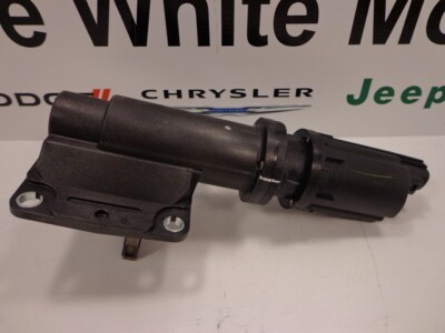

Came across this on ebay. I'm assuming that this is just the actuator that locks my truck into 4WD. Am I correct?
Yea that is not a locker, just an actuator to connect the axle.
Just came across this..
Thats for a 2nd gen half ton with a solid front axle.
