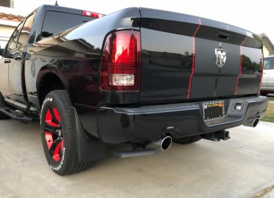

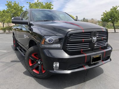

Hey everyone, decided to paint my stock rims on my 2017 RAM 1500 Sport.
I think they turned really well! Now I just hope they stay nice.... at least a few years until I buy rims and tire upgrade!
3 coats of red, masked off, 3 coats of black, then 3 coats of enamel.WVEH9033.JPG IMG_0913.JPG

Looks great!
What kind of primer and paint did you use?

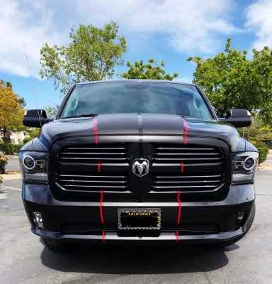

Well, that's a little reassuring! Thanks for the info. I am happy with the results, just hope my effort lasts.Painted-Rims.jpg

Not trying to scare ya man lol. Just trying to give you a heads up. Nothing you can do about it now. I can't tell if your original wheels were chrome plated or if it was a polished aluminum/steel. I think that's going to be the deciding factor. If they last, no need to get new wheels imo... Looks like you've got a sweet combo/theme going. Show us some more overall pics. Did you do the red striping yourself on the truck?

I agree. The truck looks sharp and something you don’t see everyone else doing. I really like the matte black stripes with the red thin stripes

Very nice. I don't see any reason for new wheels if that paint job lasts. Do you have that matte black on the hood? If so, would like to see it.
