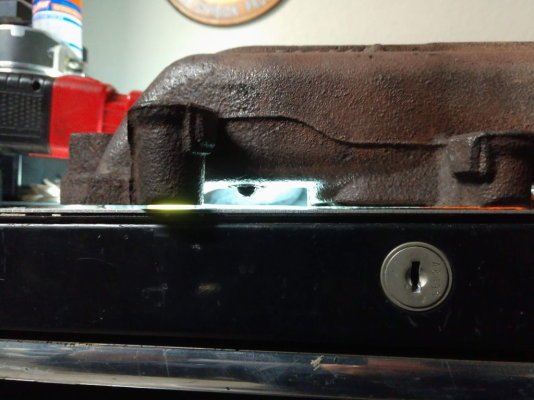

No one says they warp twice yes once warped thats it the point is they are not FLAT... once warped. On my next manifold job in 2 weeks im going to take a picture to show you how warped they are before they hit the sander. You may have been lucky and yours didnt warp as bad certainly not the case for all of them.

On my next manifold job in 2 weeks im going to take a picture to show you how warped they are before they hit the sander you may have got lucky and yours didnt warp as bad certainly not the case for all of them.
Great! I'd like to see a manifold that can't be bolted back down due to excess warpage while at the same time can be repaired with a belt sander....
Your manifold was probably only warped around .060 or less
Gasket would seal that with new bolts
.100 warpage or more would require surfacing manifold.
New bolts will not straighten a cast iron exhaust manifold.
There's always that one guy who's gotta be differant JW,and argue a point that has already been proven to work,and i think you just ran into him ;)
He's hardly worth spending the effort to argue with,as he won't give up,and after awhile you'll feel like your beating your head against a wall:rolleyes:

Go through this thread ,this pic and post is #15 in the thread,and i think if you read the whole thread you'll find more pic's showing how bad the manifolds can warp,and still be brought back to somewhat flat with a belt sander.
There's lots of material in the manifolds to take a 0.125" off the surface and still have more then enough clamping force to hold a gasket in place.
As you can see in the pics one of the ports on the end is flat and the other end of one manifold has an 1/8" gap showing light and the other had a 3/16" gap.
