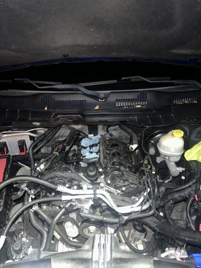

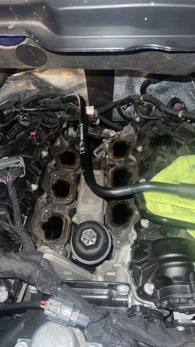

Alright guys, the dreadful day has come. My Oil Filter Housing/Oil Cooler has failed @ 105K miles.

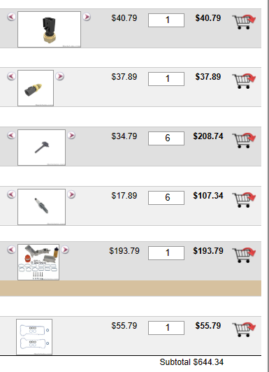

Here is a parts list I have whipped up. I plan on doing spark plugs, ignition coils, and valve cover gaskets in addition to upgrading to the Doorman Aluminum Filter housing.
Are there any parts that i'm missing here? Is there any other maintenance item I can knock out while I'm doing all of this?
What would be the best order of operations to attack all of these?
Any good tips to look out for while doing all of this is greatly appreciated as well.

I'd suggest doing antifreeze, thermostat, and radiator cap as well. It's accessible and due (in my opinion). It's not an awful job to do. Patience is key. Plan on doing some fuel/air delivery maint. while in there. Good time to clean up that area (plenum, intake, throttle body, etc.)

When I did mine, I installed new injector o-rings. I had to replace my rad as the petcock broke while draining. I also found it easier to remove the front wheels & set the control arms on 2x4's. I did my serp belt & tensioner also.

You may want to get some upper and lower intake gaskets and replace them or at least have them on hand in case you need them.

Please give us a long term update somewhere down the road. I went with the all aluminum Dorman kit a few weeks ago and install was pretty simple considering everything that needs to be removed to get to the housing. Dorman supplied all the cooler housing seals along with upper and lower intake manifold seals. I did use new OEM oil and coolant temp sensors on the Dorman so we’ll see how it holds up long term.
