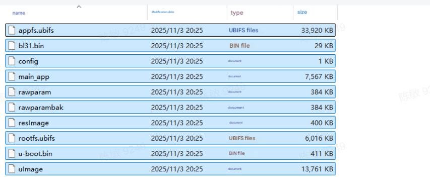

3. Keep the memory card connected to the computer (or reconnect it via a card reader), and copy all downloaded firmware files to the memory card. Refer to the attached image for instructions;
