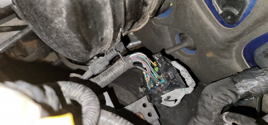

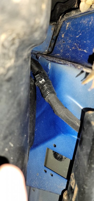

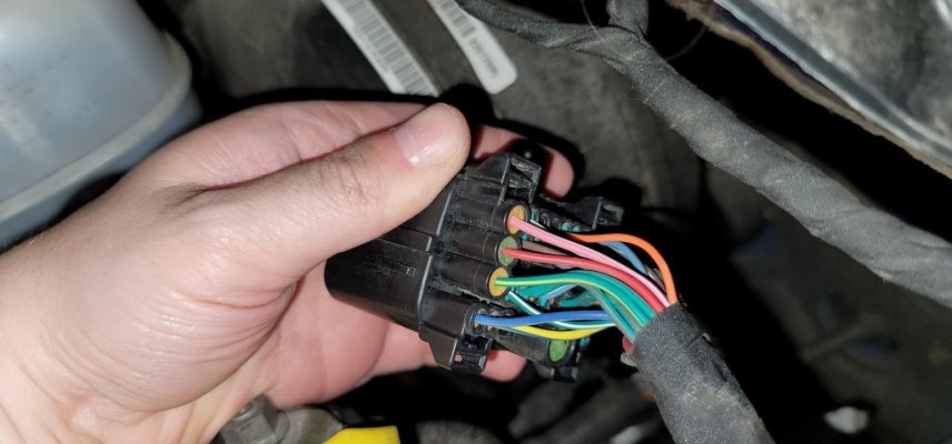

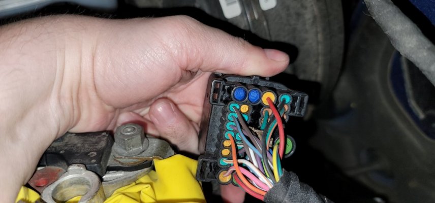

I went out to check to see what wiring I had in my c322 earlier today and I could not find any connectors behind the driver side splash guard near the firewall. I saw a few pages back that the 17+ trucks had a different style connector under the driver door along the frame so I looked there and noticed the same plug another guy posted a picture of. I find it strange as my truck is a 2015. Does this mean I would have to use the oem kit? I already have all of the tailgate wiring and handle that I pulled from a wrecked truck and was hoping I'd be able to use it still. Is there another way? (Posting pict of the connectors I did find, I believe the one is the c322 but it was mounted next to the battery) 20210626_214454.jpg20210626_214446.jpg20210626_214534.jpg20210626_214543.jpg20210626_214556.jpg

@Mpgrimm2
Mpgrimm2
Mar 30, 2014
6,103
4,186
2022 Ram 1500 (5th Gen)
Brad,
You're the first pre 2017 truck I've heard of with that style connector... It's extremely difficult to find the pins for it which is why I tell the 17+ folks to get the Mopar kit.
If I could source the pins for both sides of that one connector, I could make the harness.
