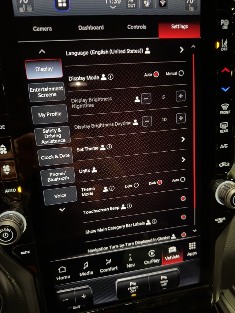

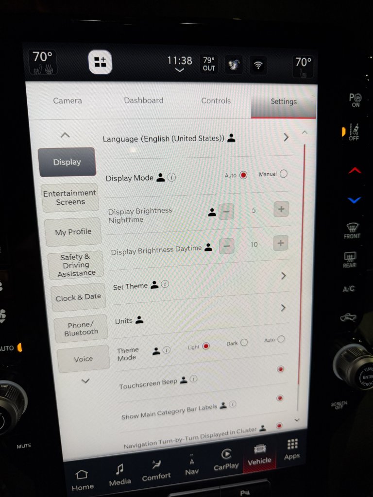

Little backstory. I have a 2026 Laramie. A couple weeks after I bought it the radio was locking up and extremely slow. Took it to dealer and they replaced the radio. Took about 6 weeks for it to come in. I got truck back and now there's no option to have screen go from dark mode to light. The option doesn't even exist. Dealer couldn't figure it out and said they checked the others on their lot and they didn't have the option either. SO they're telling me it's normal operation. The original radio had the option. When it was light outside it was a light background. When it was dark it would switch to black. There was a theme display option that is now completely gone. I called UConnect and they were no help. Just told me to take it to another dealer. Anyone else have this issue? Any ideas? @RamCares can you help me? It's a borderline safety issue as I have the panoramic sunroof and when it's bright out it's harder to see the screen and the info on it. Help please.
JimiCA
Jun 1, 2026
Prince Edward Island
2021, 2026
Hemi 5.7, Hurricane 3.0 SO
I have exactly the same issue on my brand new 2026 Rebel... Dark theme only and no "Theme Mode" option to set. I'd be interested in knowing if the factory reset and subsequent reboots fix the problem. I too did the factory reset in the middle of the afternoon, and after that the Theme was Light until my headlights came on, when it switched back to Dark and has remained that way since. I use Carplay now instead, but would prefer the vehicle navigation work as intended since I did pay for it.
Did you try following Jimmy's directions in post #9?
JimiCA
Jun 1, 2026
2021, 2026
Yes, I did the factory reset and two reboots. I lost my SiriusXM & FM presets, had to reset my phone connection and temporarily lost Nav as a widget option on my Home Screen. It did nothing to help recover the Theme Mode option. Considering the time wasted and the results, I kind of wish I hadn’t bothered.
