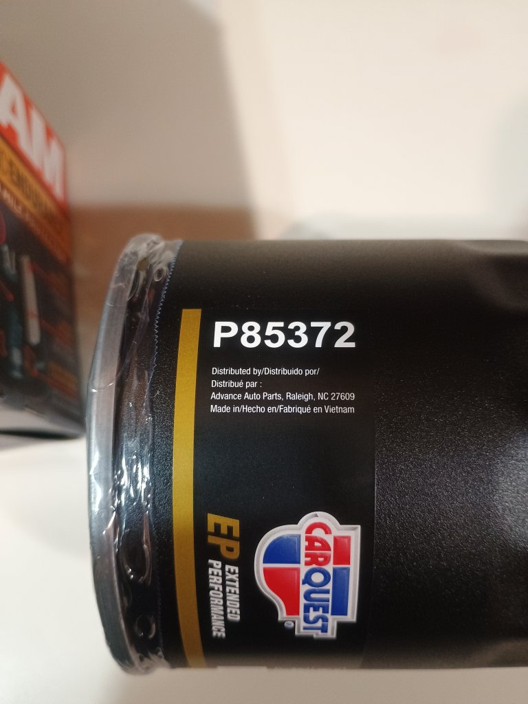

I got lucky and grabbed a couple clearance Frams from Advanced so I'm good on the Hemi for a bit, but I did need to find an oil filter for my other car this weekend. Did a quick search after I realized Fram was OOS everywhere. My quick search indicated WIX XP was a decent option. Some people recommended Microguard select and Carquest extended which are apparently Premium Guard brand. I dont know anything about Premium Guard, and I thought WIX made all the Microguard filters, so count me out of the loop I guess. I snagged a WIX XP as Oreilly had a good bundle price with some oil plus a store gift card rebate.

Premium Guard units are actually decent, they filter better than Wix XP. Their build quality, last I checked, was very good if you get units made in Vietnam or another non-China location. I've ran these in a pinch under a few names.
