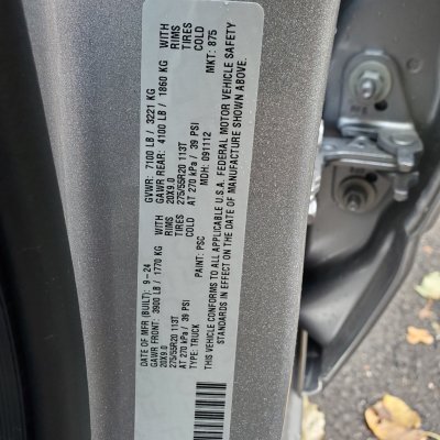

Looking to see if anyone knows how to find the towing capacity on my 2025 Ram. I looked at the sticker and can only find the GVWR and the GAWR for each axle. Nowhere does it show GCVW. I have seen a chart, so I have an idea of what it "should" be, but I sure wish I could see it somewhere on the actual truck. Does anyone know where they put this info, since it isn't on my door stickers?

Scoll down to 'Documents' > 'Towing Charts':

Thank you for providing the chart location! I have seen them before, but not to this level of detail. Shows the same amount of towing capacity I was expecting. I just find it odd, they don't put it on the truck anywhere anymore...
I don't think they ever have from what I remember.

I have never seen any tow capacity listed on any truck I've ever driven. You get curb weight and GVWR - that's it.
