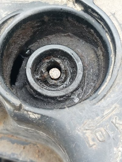

Well. I finally got a day off that it isn't raining all day for and was able to get the old intake manifold out and this is what I'm working with here. As you can see, there really isn't anywhere to insert pliers to "grip on" and pull it out. It appears that the valve has become one with the manifold.

Just found this thread. Taking the manifold off was definitely the right call. I would VERY carefully start removing the old PCV valve from the centre out, that way I could re-use the factory manifold. If you proceed carefully it should work out fine. A little judiciously applied silicone might be needed when you fit the new PCV.
If that doesn't work, I would go to the wreckers and get a takeoff manifold. Let us know how you make out.

Got what was left of the old valve out. The passages were pretty sludged up, probably from neglectful oil changes. Cleaned them up and reinstalled everything, but the thing still runs horribly. Not sure what I did wrong, made sure to get all the spark plug wires to the right spots. Everything is indeed plugged in. Tried hooking up my scan tool and checked values and nothing appears to be out of the ordinary, no odd codes other than an EGR code which has been there since before this whole situation began. Turned it off and restarted it to see if it would run any better and saw a puff of smoke (couldn't see what color, it was dusk), and now I don't want to turn it back on until I figure out the source of the smoke. I'm almost considering throwing in the towel on this and calling a mobile mechanic or getting it towed somewhere.
I should mention the thing has a very sizable exhaust leak that I hadn't gotten around to fixing yet so I can't listen for any weird, unusual noises related to engine internals. Nothing got into the intake ports, made sure of that. Oil pressure is good. Well, idk if it's good, just that there's some oil pressure since its just a dummy gauge.
