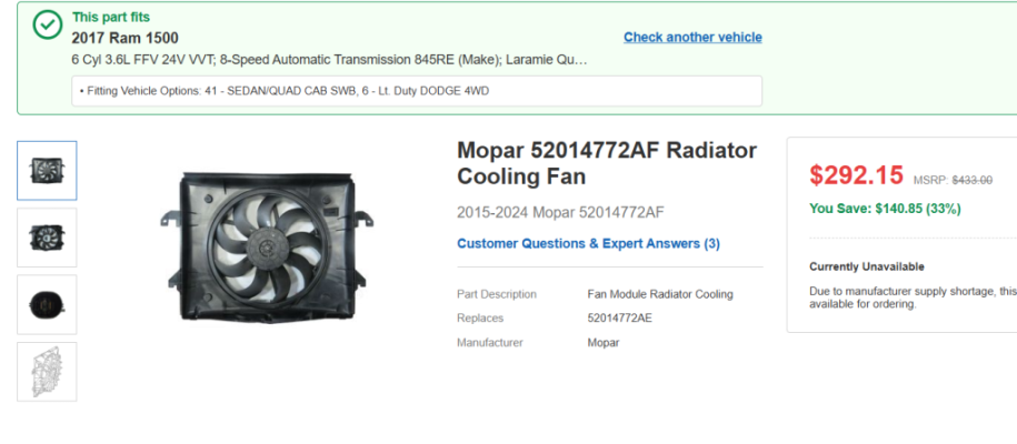

According to the schematics @ MopartPartsGiant, your electric fan has an integral shroud that is built-in, as part of the electric fan assembly. #15:
I'm assuming your truck is electric fan only? No clutch fan? If I remember right, the Pentastar trucks are electric only.

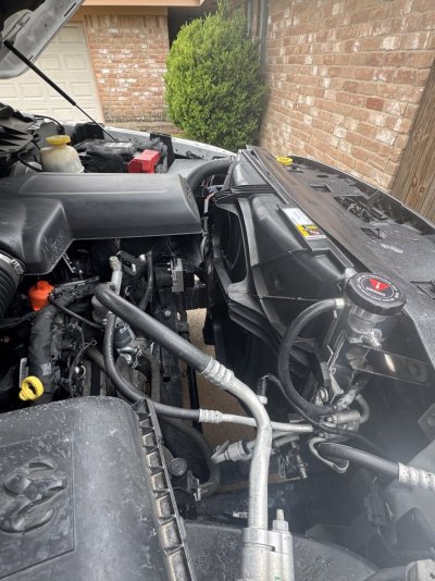

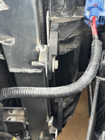

Yes, it has the electric fan. Just doesn’t look like it is close enough to the radiator.

That looks normal
