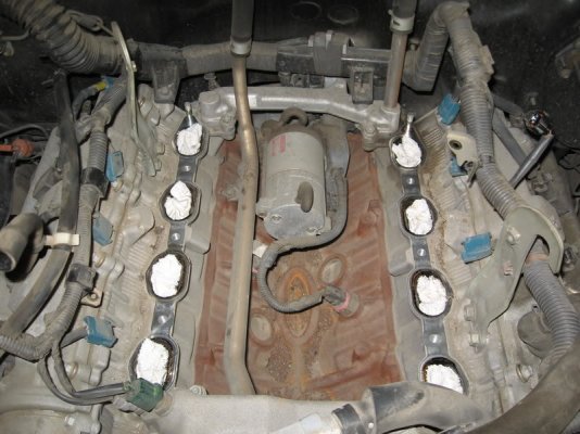

At least they are not done like Toyota 4.7 L the starters are a 4.5 hr min job they are under intakes in the valley between the cylinder banks
That's where they put the Denso starter on my ZR-1 Corvette. Yes it was a Denso, not a Delco. I never had to change it though.
What moron thought that was a good idea?? I guess he won out over the guy that said put it the transmission. This only because the guy who said put it on the side of the engine like has been done for decades was out of the office that day.
